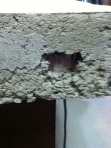

Step 6: Remove the Casting Gently
Surprise ! big hole on the side, sing don't worry be happy I make some slury.
find slury mix of Portland cement like this http://www.ehow.com/how_6786972_make-concrete-slurry.html
warning Portland cement is greenish looking if you like hulk it's OK or the other I would used Hydraulic cement poly-plug or other fast seting cement which remain grey.
Step 7: Remove All the Hole on the Side With Slury Mix or Hydrolic Cement
slury on he side and hick paste of Portland cement and rub top and side give this nice greenish side with no more hole.

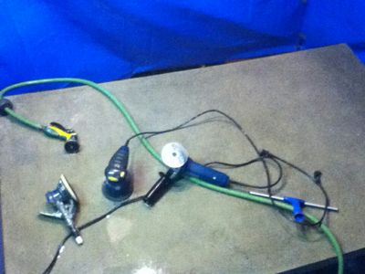

Step 8: Now Get Your Rain Coat It's Polishing Time ! With the Hose and Electricity = Get Gfc Braker or Outlet or You Die ! Water and Electricity Do Not Mix. or Just Go Buy a New Table Witch at This Point Was Considering...

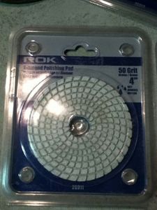

find these diammond polishing pad at specialized tool store or buy it in China directly at aliexpress.com Diammond polishing pad http://www.aliexpress.com/ start with 50 grit, find with water always on not too fast.(build a variable speed grinder outlet with a light dimmer plug your grinder into it) lower the speed. grind with a stream of water.
move too the 100 pad. now if you want to tint your concrete now is the time after the 50 grit and Before the 100 because after that it will be too late as I will discovered it later....
used water based tint like this https://youtu.be/c2J2dgDRJcw remove the excess with rag
watch that video https://youtu.be/-r3sMWCe920
at the end use the 400 grit for me it was smooth enough
