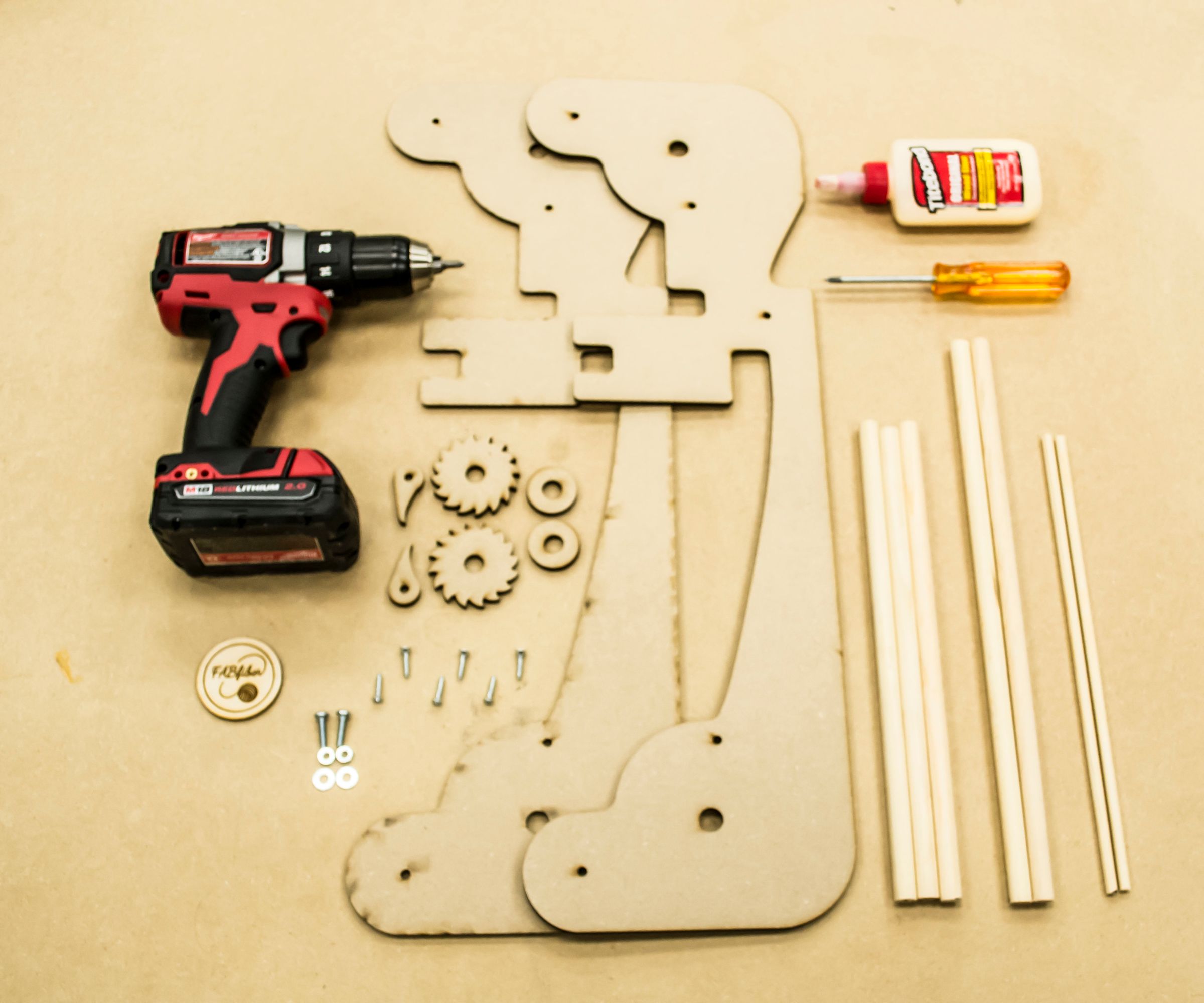

1 x 12 inch long dowel of ½” diameter
1 x Drop Spindle laser cut piece found HERE
1 x ½” base cup hook
White Elmer’s Glue or Wood Glue
