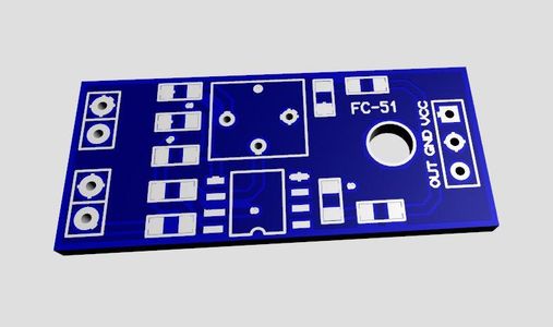

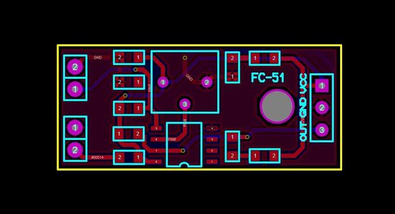

Step 3: PCB LAYOUT
Before We continue with the PCB layout, it is important to indicate that You can use any software for PCB Desing, believe me there are many options, even if you use the best software it will not mean that you are the best pcb desinger, so in this case We are going to use Proteus highly recommended if you want to enter in the pcb design world like a professional.
So after We finished and check our schematic circuit We need to switch from schematic to PCB layout. We can see the PCB with the Ground Plane, this helps for noise filter on the pcb. Also is important to remember that in the case of the microcontroller is necesary to place the crystal and the capacitor the closest possible.
Here after we finish the pcb layout We can get the Gerber files, there are two kind of gerber files we have to pay attention to it, the first GerberX2 and the other Gerber RS274X, most of the manufacturer use the second one Gerber RS274X, in some software we will just GerberX2 and Gerber (In the case of Proteus).
You can also download the Gerber Files: HERE
There are two kind of gerber files we have to pay attention to it, the first isGerberX2 and the other Gerber RS274X, most of the manufacturer use the second one Gerber RS274X

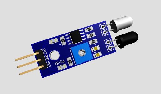

Step 4: 3D MODEL
One of the features of Proteus is the 3D visualization, the 3d visualization is important and it give us the posibility to see and check our PCB and how it would be in real, also it can show us the components distribution and dimensions. Before I did not consider this feature so important, but the 3d visualization can show us if our footprint dimensions are ok, if all the components will be places without touching each other by mistake.
