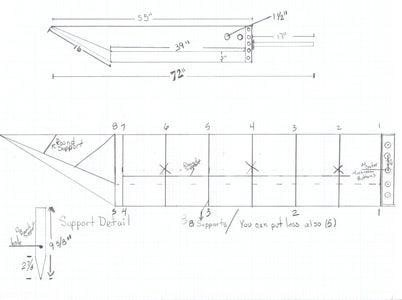

Step 1: Plans
It would be a good idea to take a look at these plans ahead of time if you're going to make this, mainly so you don't end up making everything up as you go along like I did. 3 sets of diagrams are shown below to help you better understand the structure of the prop. Sorry for the lack of metric units.

Time to draw out the whole blade of the brown craft paper. Measure it all out and then draw supports about 10in apart, maybe a little bit less. This is where you will put wood supports on the inside of the sword. One you have all that measured out and drawn then take your wood and cut it out in measures, one for the big long back and various for the supports. Now on the big long piece for the back draw on the point and cut that out with the saw.
