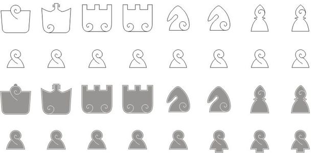

Step 2: Step 1: Engrave Ornament
Engrave ornament and color on the figures
I set raster: S50, P30

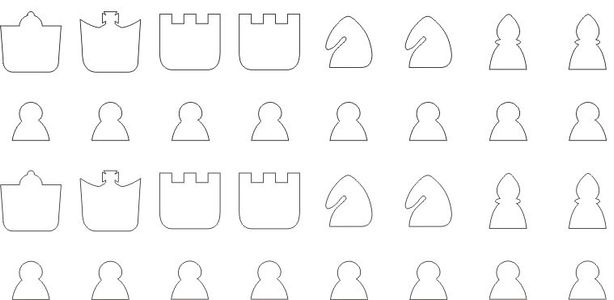

Step 3: Step 2: Cut Figures
I set: vector: S6, P80

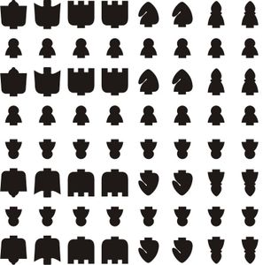

Step 9: Corel Draw File
Welcome to use this file as the layout.
You will probably need to change settings for your laser machine.
