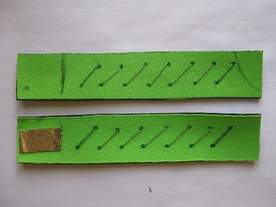

Step 3: Preparing Materials
Once you've created the stencil, trace it onto the neoprene so that you have two IDENTICAL (not mirrored) pieces.
Using interfacing, fuse a small piece of stretch conductive fabric (see photos) to the end of each piece of neoprene. On once piece it should be on the green side (inside) and on the other on the gray side (outside). This is so that later on, once the sensor is sewn together, the conductive fabric only faces one side (this is more for aesthetic reasons, so it will still work no matter which side you fuse the conductive fabric to).

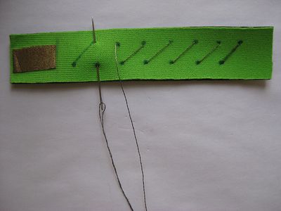

Step 4: Sewing
Now that both sides of your sensor are prepared, thread a needle with a good amount of conductive thread. You can take it double or single. I prefer to take it single.
Sew into the neoprene from the back/outside (in this case grey side). Start at the end furthest away from the patch of conductive fabric. Stitch back and forth as shown in the photos. When you reach the end, sew the thread to the conductive fabric. Make at least 6 stitches to connect the two.
Do this sewing for both pieces of neoprene, with the exception that in once case the conductive fabric is on the other side of the conductive stitches. Still you want to attach the conductive thread to the conductive fabric patch with at least 6 stitches.
The reason the stitching on both sides must be identical is so that when they lie on top of each other (facing each other) the stitches crisscross and overlap in one point. This has two advantages. First that it is unlikely that the stitches will not line up and not make any overlapping connection. And secondly that the surface of connection is not too big. I’ve found that if the conductive surfaces are too big that the sensitivity of the sensor is no longer good for what I want.

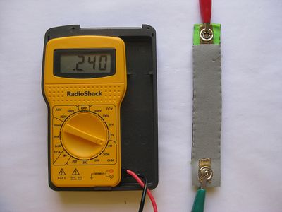

Step 7: Multimeter Test
Now your sensor is finished!
Hook either end up to a multimeter and set it to measure resistance. Each sensor will have a different range of resistance but as long as it is not too small and works for your purposes, all is good.
The sensor I made had following ranges:
Lying flat: 240 K Ohm
Pressing with finger: 1 K Ohm
Lying on side: 400 K Ohm
Bent: 1,5 K Ohm

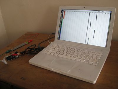

Step 8: Software Visualization
To visualize the change in resistance in the bend sensor you just made you can also hook it up to your computer via a microcontroller (Arduino) and use a little bit of code (Processing) to visualize it.
For Arduino microcontroller code and Processing visualization code please look here >> http://www.kobakant.at/DIY/?cat=347
See the orange bar in the pictures. How it is on the right of the computer screen when the wrist is bent. And at the very left when the wrist is straight!!
