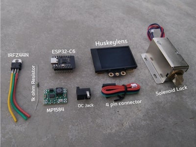

Components
  1. DFRobot Huskeylens
  2. DC Female Socket

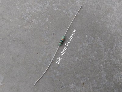

  3. 10k ohm Resistor
  4. DFRobot Beetle ESP32-C6
  5. MP1584 Buck Converter

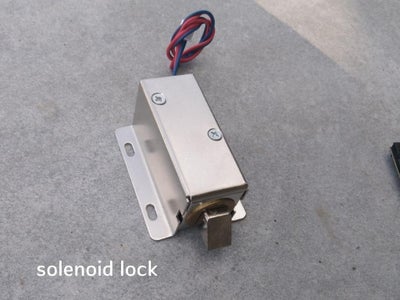

  6. 12v Solenoid Door Lock

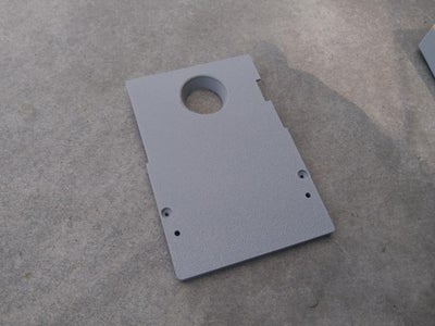

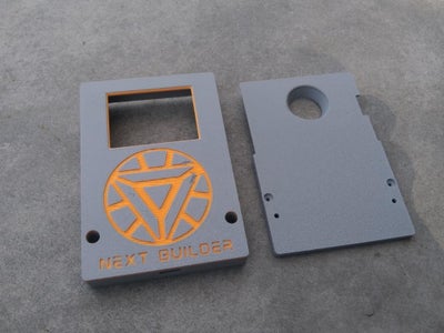

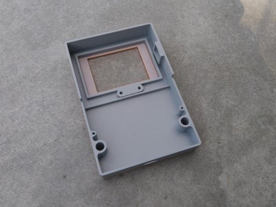

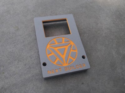

Step 1: CAD & 3D Printing
To start this project, I Started designing the CAD using Fusion 360. It’s a simple and compact design that’s easy to print and assemble. If you’d like to view or edit the model, you can open it directly in your browser using the Fusion 360 web viewer. Feel free to customize it however you like.
For 3D Printing, You can directly download the required STL files below:
  1. Main Panel.stl
  2. Back.stl

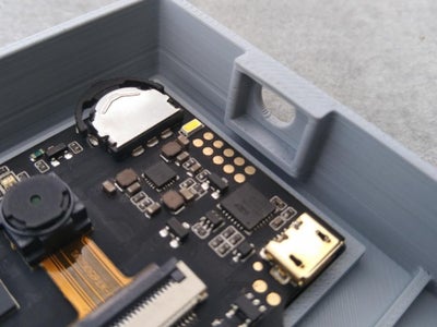

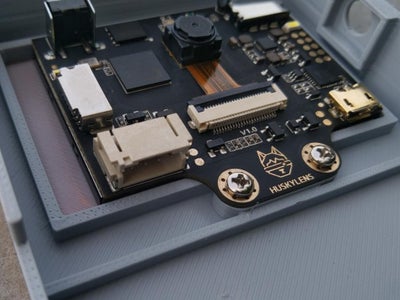

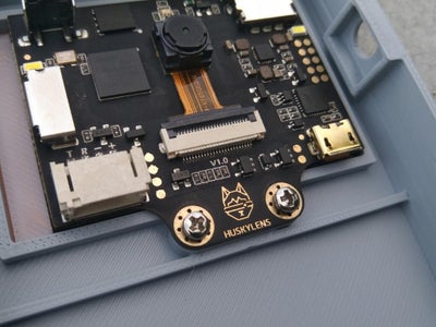

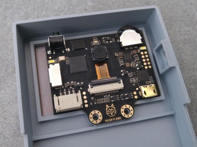

Step 3: Huskeylens Assembly

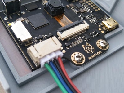

Start by placing the HuskyLens into its dedicated slot inside the enclosure. Make sure it is aligned correctly with the front opening for a clear view. Once positioned, secure it firmly using the two provided screws.

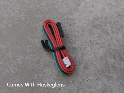

After securing the module, connect the included 4-pin JST connector to the HuskyLens. This connector makes the wiring neat and simple, ensuring a stable and reliable connection.

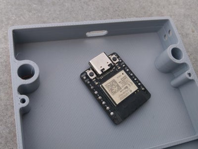

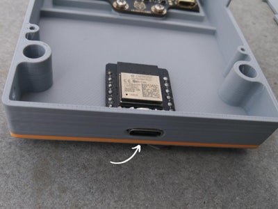

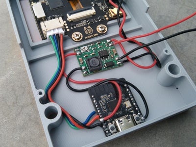

Step 5: Microcontroller Assembly

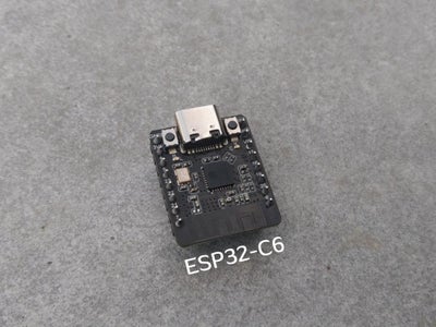

Place the microcontroller inside the enclosure at the cutout for the Type-C port. Align it properly so the Type-C connector is accessible from outside for easy programming. Apply a small amount of T-7000 glue to fix it in place. Don’t use too much glue—just enough to hold it securely.

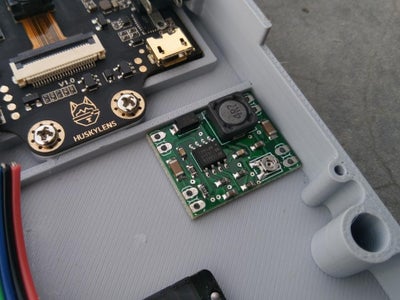

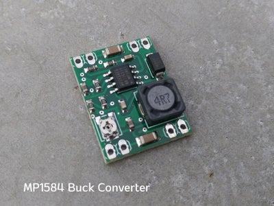

Step 6: MP1584 Setup & Assembly
There isn’t a dedicated slot for the MP1584 buck converter, so you can place it in any free space inside the enclosure. Before fixing it with T7000 glue, first set it up for a stable 5V output. To do this, connect two wires to the input and provide 12V. Then, measure the output voltage and carefully rotate the potentiometer on the buck converter until it reads exactly 5V. Once it is set, secure the module inside the enclosure.
Warning: Be gentle while adjusting the potentiometer. Rotating it too much can cause sudden voltage spikes, which may damage your circuit.

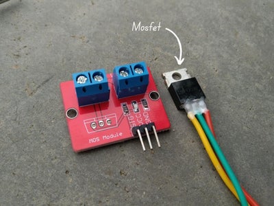

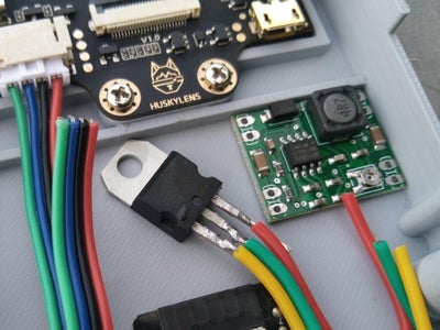

Step 7: Mosfet Assembly
Since the enclosure is designed with a thick wall for a more professional look, the MOSFET module could not be placed directly inside. To solve this, I removed the MOSFET from the module first.
There isn’t a dedicated slot for the MOSFET, so you can place it in any free space inside the enclosure. Once positioned, secure it firmly using T-7000 glue. Make sure the MOSFET is fixed properly and has enough space for air circulation, as it can heat up during use.

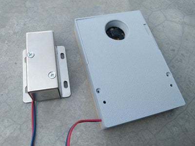

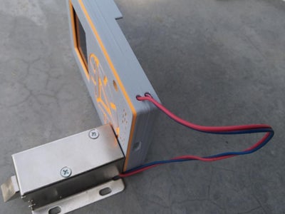

Step 8: Solenoid Lock
Pass both wires of the solenoid lock through the two small holes provided in the enclosure. These holes are made specifically to allow the wires to pass through easily for proper connection. Ensure the wires are passed gently without pulling too hard to avoid damage.

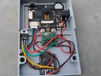

Step 9: Connection
You can follow the circuit diagram above to make all the connections. However, for clarity, I’ve also explained each connection step by step below.
HuskyLens AI Camera
  1. VCC → 5V pin of ESP32
  2. GND → GND of ESP32
  3. TX → RX of ESP32
  4. RX → TX of ESP32
  1. VIN → 5V output from MP1584 buck converter
  2. GND → Common GND (shared with HuskyLens, MOSFET, and power supply)
  3. TX/RX → Connected to HuskyLens
  4. GPIO pin → Gate of MOSFET (through resistor)
MOSFET (for Solenoid Control)
  1. Gate → ESP32 GPIO pin
  2. Source → GND
  3. Drain → Negative wire of Solenoid Lock
Resistor connected with Gate & Drain Pin
Solenoid Lock
  1. Positive wire → 12V supply
  2. Negative wire → MOSFET Drain
Power Supply (12V input via DC Jack)
  1. Positive → Solenoid Lock positive wire + input of MP1584 buck converter
  2. Negative → Common GND to MP1584 Buck Converter.
  1. Input + → 12V supply positive
  2. Input – → 12V supply negative (GND)
  3. Output + → ESP32 VIN (5V)
  4. Output – → ESP32 GND

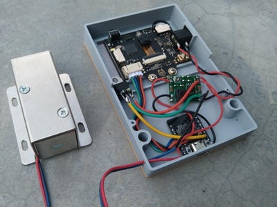

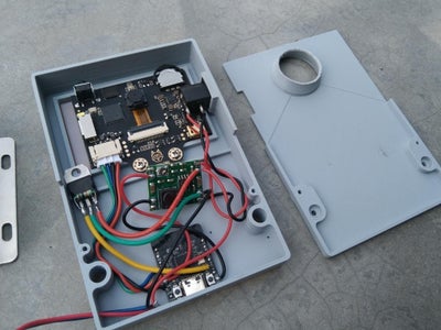

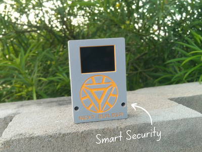

Step 10: Final Assembly
Once all the components are in place, align the cover with the bottom enclosure and ensure the camera opening is clear. Match the orientation properly, then secure the cover using two screws. Do not overtighten the screws, as this may damage the enclosure or misalign the cover.

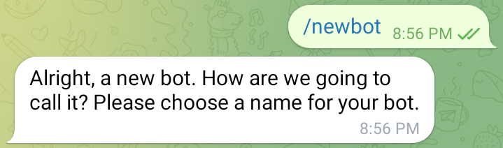

Step 11: Telegram Chat Bot
Creating a chatbot on Telegram is quick and easy. Open Telegram and search for @BotFather, then start a chat. Type /newbot and follow the prompts.
  1. Bot name: Enter any name you like for your project.
  2. Username: Choose a unique username for your bot. It must end in bot Like this, (for example: TetrisBot or tetris_bot)
Once completed, BotFather will send you a congratulations message along with your Bot Token ID. Make sure to keep your token secure and store it safely, it can be used by anyone to control your bot, as well as it will be required later to connect your hardware with the bot.

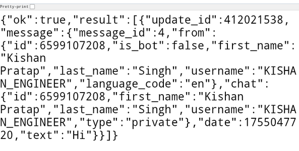

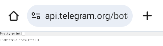

Step 12: Chat ID
After creating your chatbot, open your internet browser and go to;)
https://api.telegram.org/bot<YOUR_BOT_TOKEN>/getUpdates
Replace <YOUR_BOT_TOKEN> with the token you got from BotFather. At first, you might see some basic data with true or false values. Now, go back to your chatbot in Telegram and send it any message, such as hi. Then return to your browser and refresh the page. If everything is correct, you will see some data along with your Chat ID, which will be used later in the code.

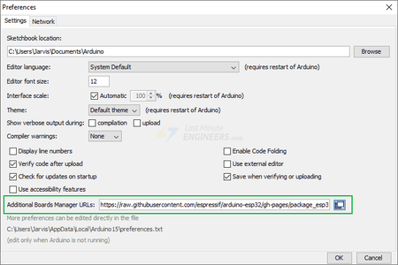

Add the ESP32-C6 Board Support URL
  1. Open Arduino IDE.
  2. Go to File > Preferences.
  3. In the Additional Board Manager URLs field, paste the following URL:
https://espressif.github.io/arduino-esp32/package_esp32_index.json
  1. Click OK to save your changes.

Step 15: Testing
Now it’s time to bring the project to life. Provide a 12V supply to the DC jack — you can simply use a 12V adapter for this. Once the power is supplied, wait for about 5 to 10 seconds, as the microcontroller needs a short time to connect with WiFi.
After it connected successfully, I pointed the camera toward my face — and you won’t believe how well it worked! The HuskyLens instantly recognized me, and the door unlocked almost immediately. The responsiveness was even faster than I expected — it felt like a real professional smart lock system.
On top of that, I also received a notification on my Telegram via the bot I created, confirming the unlock event. This made the whole experience more exciting and reliable, as I could monitor the activity in real-time.
