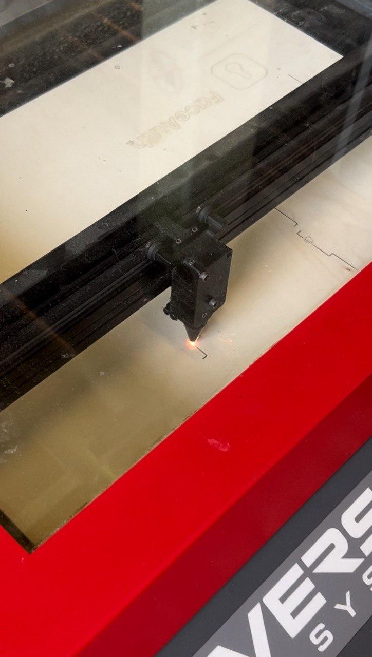

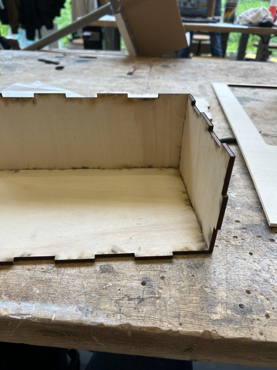

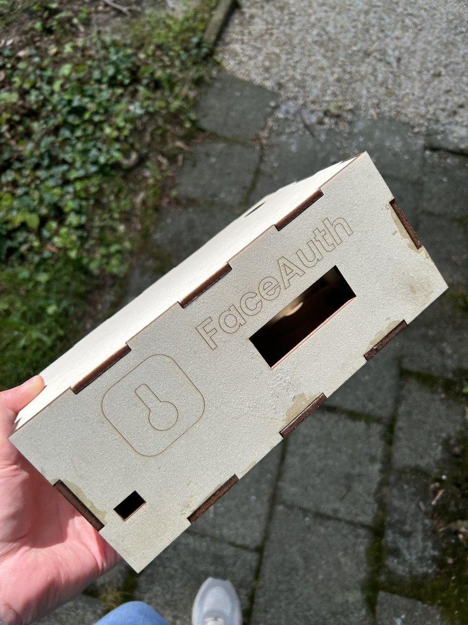

Step 8: Making a Box for Raspberry Pi
For the assembly part, you'll need a 5mm thick multiplex wood sheet measuring 600x450mm for laser cutting. First, create a file in Illustrator that instructs the laser cutting machine on how to cut the wood plate. I'll show you my version of illustrator file, so you could use it.
Next, assemble the pieces by gluing them together, leaving the top piece unglued to allow access to the Raspberry Pi. Position your LCD display into its designated hole and secure it with double-sided tape to prevent it from falling.

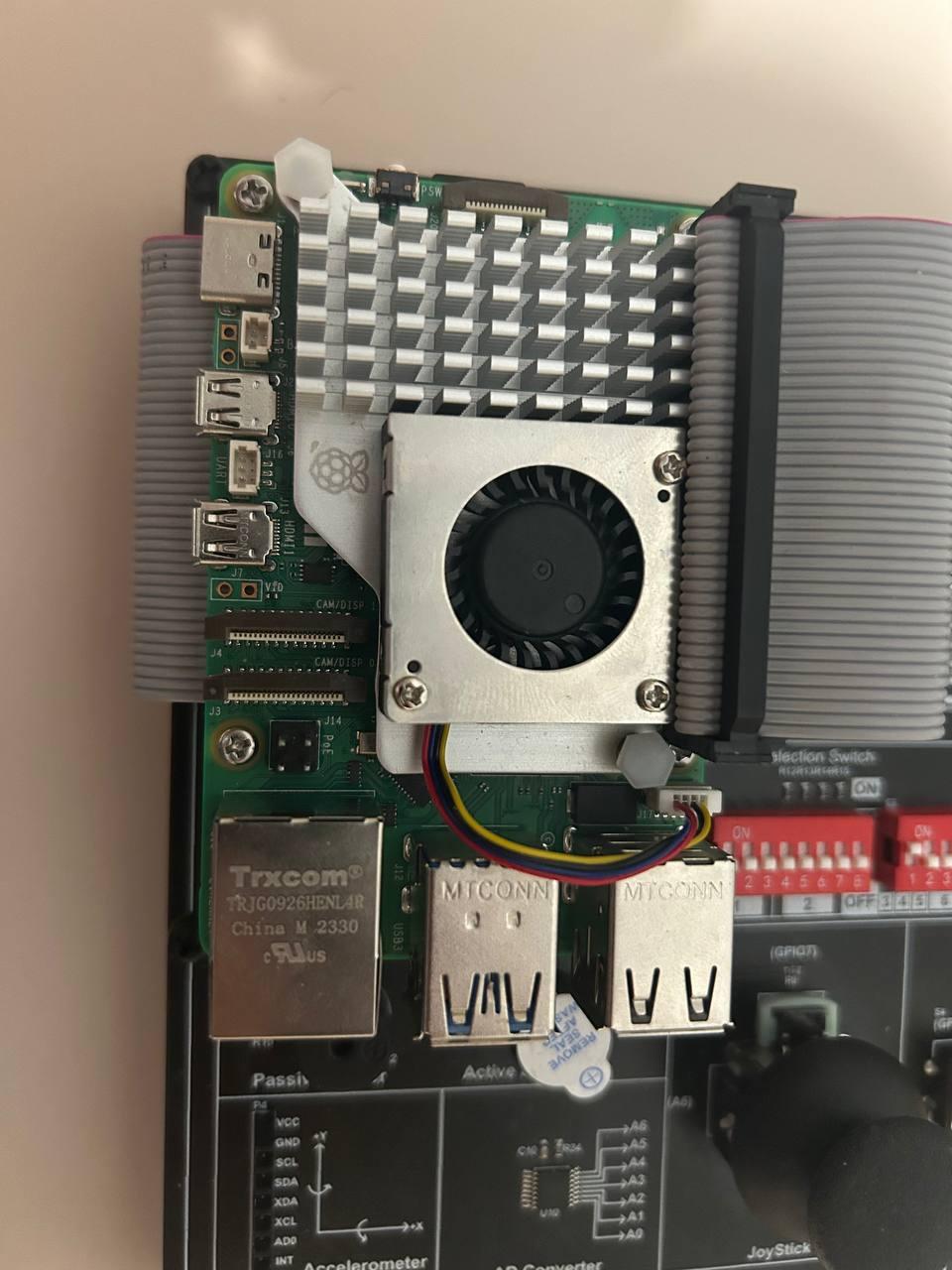

Step 9: Connect to Raspberry Pi and Deploy
Here's how we connect our Flask app to a Raspberry Pi. First, ensure you replace targetDeviceMac with the MAC address of your own Raspberry Pi:

Now, let's configure the Raspberry Pi to establish a connection:
import threading
import queue
from LCD import LCD
# Bluez gatt uart service (SERVER)
from bluetooth_uart_server.bluetooth_uart_server import ble_gatt_uart_loop
def main(lcd: LCD):
    # Initialise display
    lcd.init()
    i = 0
    rx_q = queue.Queue()
    tx_q = queue.Queue()
    device_name = "mykyta-rapsi" # TODO: replace with your own (unique) device name
    threading.Thread(target=ble_gatt_uart_loop, args=(rx_q, tx_q, device_name), daemon=True).start()
