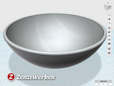

I downloaded 123D Design from Autodesk, which is an easy to use 3D modeling software. Next I designed the basic shape for my bowl by intersecting two spheres. I cut off a little of the bottom to give the bowl a flat spot to stand on. To get a nice rim I rounded off the edge. I proceeded by exported the model as a stl file.

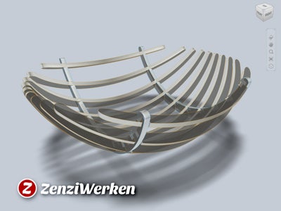

It's really fun to experiment with different modes, but it takes some time to get to an usable output. For my bowl I used the "Curve"-Mode, which allows you to "bend" your slices according to the form.

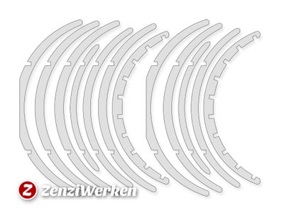

When I was happy with the result I outputted EPS files. The recent version can nest the parts, but I preferred to nest them myself.
Step 3: Nesting the Parts
I opened the EPS files in Illustrator and nested them carefully. As I was about to mill the parts on my desktop cnc machine I had to consider the tool diameter in terms of distance between parts. Luckily all parts did fit on one sheet of plywood with the maximum size of my machine bed (300 mm x 400 mm / 12" x 16").

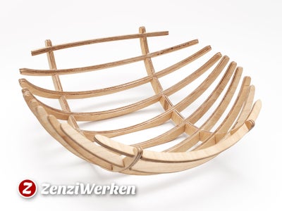

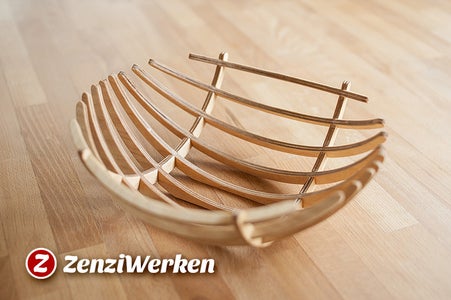

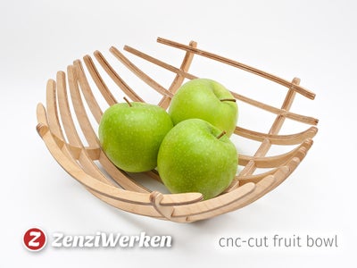

I cut the parts with a spiraltoothed 1.2 mm cutter and sanded them on a spindle sander. The I glued all the parts up. Common wood glue is perfect for this. When everything was set, I finished the bowl with oil. This intensifies the wood structure and makes it more resistant against moisture.
