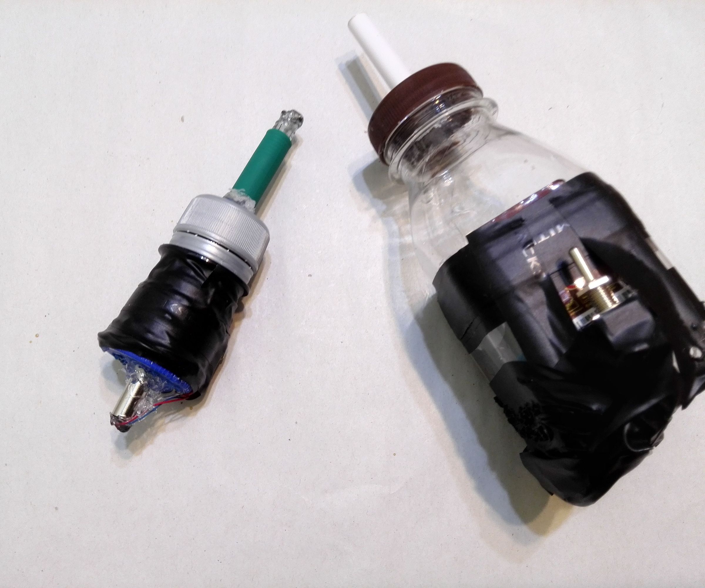

I'd made one simple mini of these kind of stuff in https://www.instructables.com/id/DIY-Mini-Vacuum-C... ,so I just decided to make a multi-tool out of PC fan; Finally It doesn't seem to be well fabricated but it's a genius idea and worths sharing.
