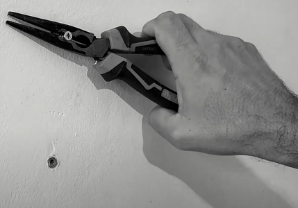

Step 2: Wall Plugs Removal - the Old Way 1
There different simple known ways to remove wall plugs.

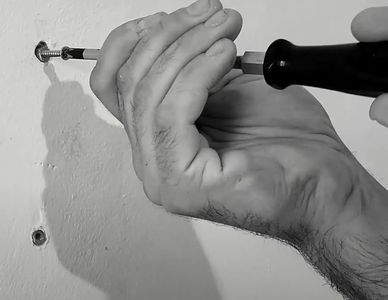

One of them is using a screw. You insert the screw into the plug, grab the screw with pliers and pull it.

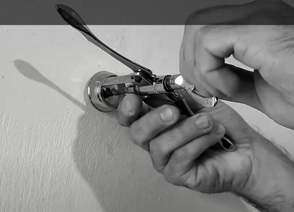

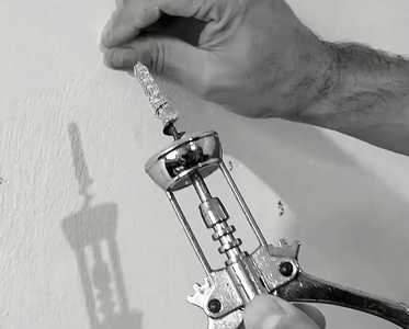

Step 3: Wall Plugs Removal - the Old Way 2
Other way to pull wall plugs, is using a corkscrew (wine opener).

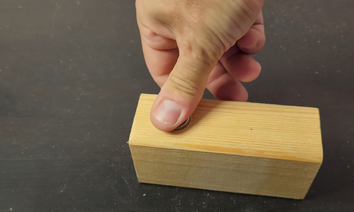

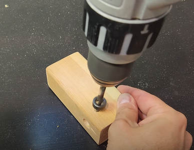

Step 5: Inserting the Bearing

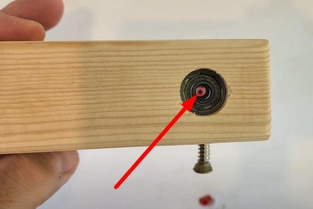

I drilled 19mm hole (according to the bearing diameter) in the wood, and inserted the bearing.

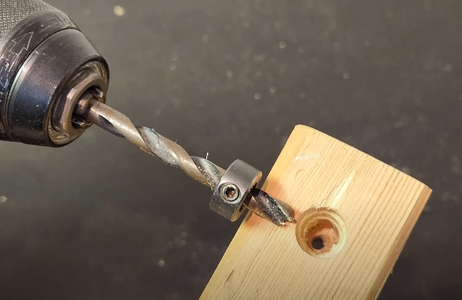

Step 6: Drilling Back Side
I drilled a 4.5mm hole through the bearing, to the other side.

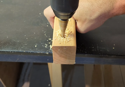

Step 7: Drilling Front Side - Hole for the Plugs

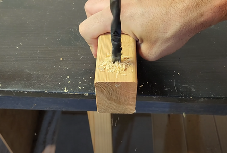

I turned the wood and drilled a 10mm hole from the other side towards the bearing, 27mm long. The depth should be enough to contain the pulled plugs length.
After that I slightly widened the opening of the hole with a cone drill, so that the plugs can go in more smoothly.

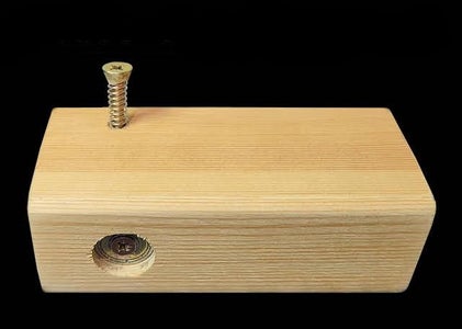

Step 8: Making the Push Button
In order to hold the pulled plug in the tool, I needed some kind of push button. When I thought how to make this tool, I initially looked for different push buttons online. I didn't find something that fits, so I decided to make a DIY button.

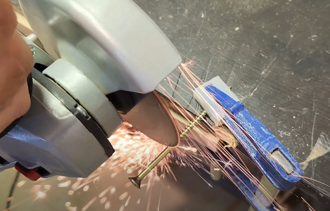

I took a screw (70mm*3mm) and cut it to 30mm long, using an angle grinder.

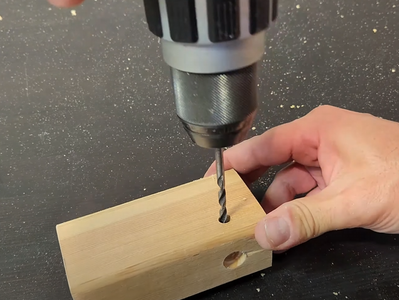

Step 9: Drilling Hole for the Push Button
I drilled a 7mm hole from the top, with depth of 10mm. This hole mustn't reach the previous vertical hole.
This hole will hold the 'push button' spring later.
Step 10: Drilling Hole for the Push Button - Continue
In the same position in the top, I drilled a 4.5mm hole. Unlike the wider hole, this hole continues into the vertical hole.
This hole is smaller, in order to limit the spring from being inserted deeper, but not the screw I cut.
(The hole thickness should be bit wider than the screw).

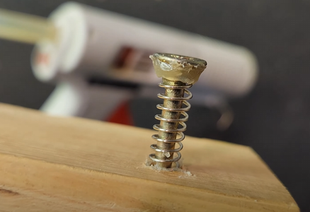

Step 11: Making the Push Button - Continue

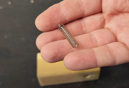

I used hot glue to glue the spring to the 7mm hole I drilled at the top in the previous steps.
After that, I put some hot glue around the bottom of the screw head that I cut, and connected it to the spring.
The push button is ready and the spring & screw can't fall.

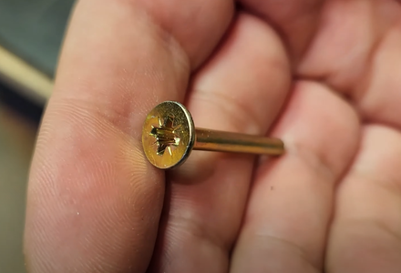

Step 12: Inserting the Main Puller Screw
I took another screw (70mm*3mm) and inserted it through the bearing.
This screw will be used to pull the plug from the wall, using a drill driver / impact driver. (I'll call it the 'puller screw')
The bearing helps to rotate the screw fast and smoothly.

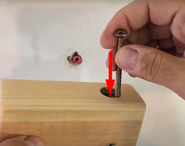

Step 13: Pressing the Push Button
When pressing the push button, the button screw should reach the puller screw, like in the picture.
When the wall plug is pulled and worn on the screw, the push button should lock it from rotating.
