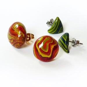

With your Xacto knife, cut a small piece (less than .25”) off the log at an angle. Cut the rest of the log up alternating the direction of the angle. Make the sizes fairly even. The shapes can vary.
Each piece will make one earring stud. Ending up with eight or ten is ideal.
Note:
These earrings are supposed to be like irregularly shaped gemstone nuggets. No two will be exactly alike. I like to match up the ones I would wear together at the very end of the project.
Step 9: Attach Posts
Gently pick up one piece of banded epoxy with your dominant hand. Make sure the banding is facing up. Pick up one earring post with the other hand. Use your index finger to press the epoxy lightly onto the pad, just deep enough that they stick together.
Keep holding the post and smooth the top of the epoxy with your fingers. Start at the top and then smooth the sides. You can carefully adjust the shape if you want. Be very gentle! The top should be slightly rounded.

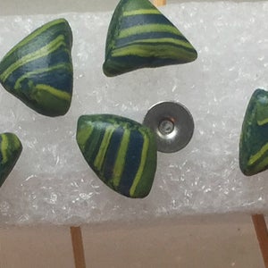

Poke the posts into your foam and let them set up for 15-30 minutes.

Very, very gently rub each earring top on your palm or on a soft piece of fabric while holding the post. Hold the post perpendicular to what your buffing it on. Briskly rub the earring back and forth or in circles to buff the top and edges of the “gemstone”. This will remove fingerprints and polish the tops. Check often - you will see a nice shine develop.
Step 13: Cure Fully
Put all the earrings back in the foam for at least 24 hours.
Don’t touch them again until then.

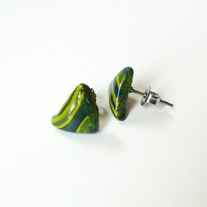

Mix a very small amount of clear epoxy (you won’t need more than a teaspoon.) according to package directions.
Then hold one earring upside down, by the post. Get a drop of clear epoxy on a toothpick and apply it to the back of the “gem”. Spread the glue to the edges. It should be a very thin layer. Make sure you’ve covered the metal pad.
Use the epoxy to glue any separated posts back on.
Set them aside for a day or two to cure fully.

Step 18: Cured!
When the resin is fully dry (a day or two), your posts are ready to wear or add shine.
Step 19: Matching Game
Sort the posts by matching up pairs that look good together. I find this to be a fun game : )
Step 20: Finish
Add ear nuts and they're ready to wear.
