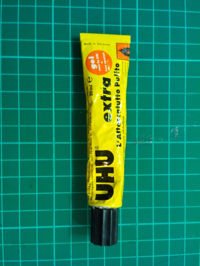

I am using UHU to glue the wire on the base and glass colours instead of enamel powder as they are more viscous , transparent and bright.

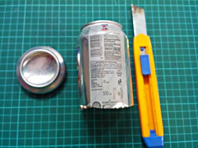

Step 1: Prepare the Base
First cut the bottom part of the can with a cutter. Trim it down with scissors till you reach the inner most edge. cut two leaf shapes from the circle. make sure both are of same size and shape. you can use two whole circles two if you like large sized earrings.
Sand of the edges as they a very sharp.

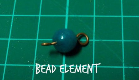

I also added a bead element at the top. you can use any bead as per your colours. I used a turquoise coloured onyx. Use a 3 cm copper wire to wrap the bead.

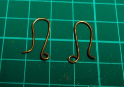

Step 6: Make Some Earwires....
You can use ear wires available at craft stores. but i made some as i wanted them to be in copper.
Cut two 5 cm wire and shape them with your round nose pliers.
Hammer them lightly to harden them.( yes, that is my hammer from stone age)

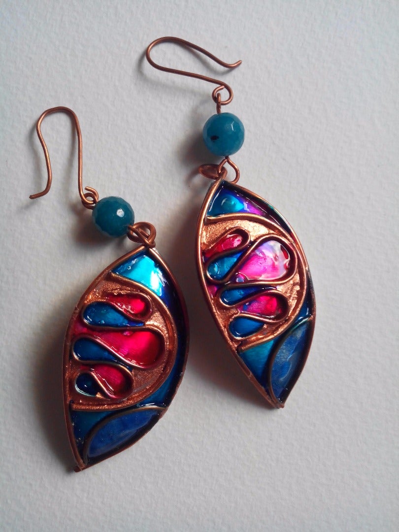

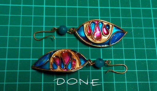

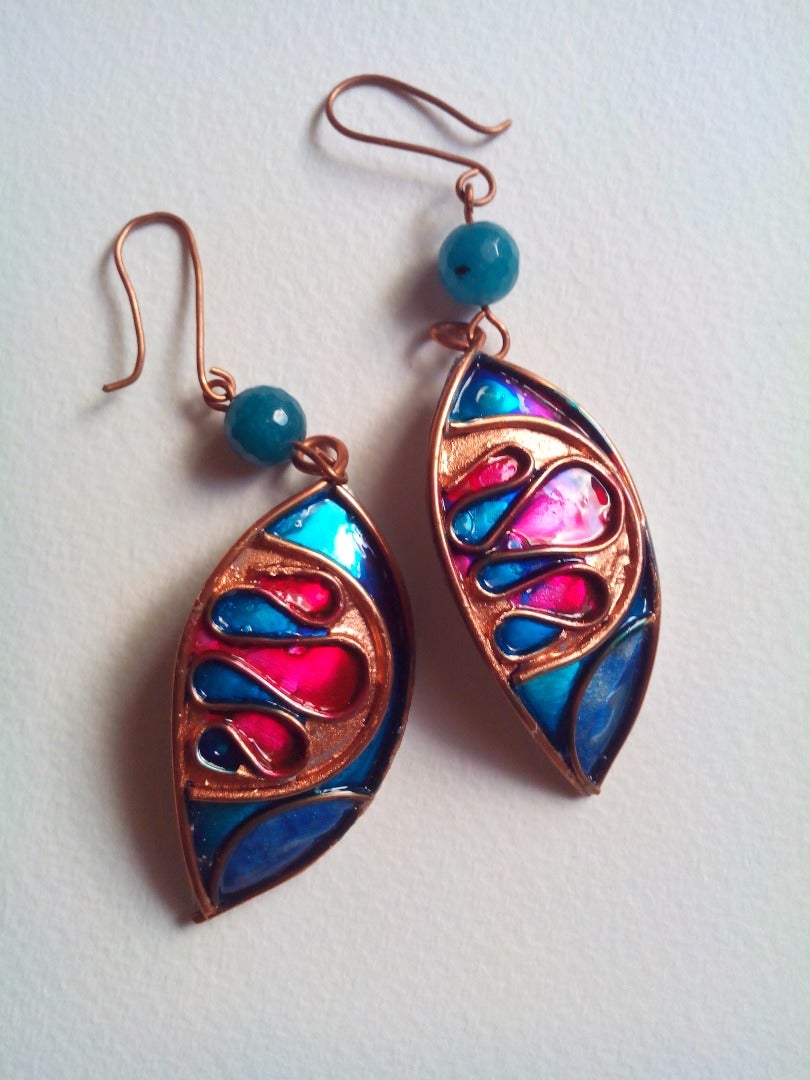

Attach your bead element and ear wires to your base and your done. you can give your earrings a protective coating of enamel varnish or lacqure. just avoid the knots as they might stick due to varnish.

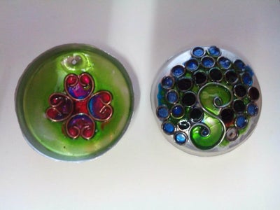

Step 8: Variations...

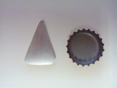

You can experiment this technique on different things. like use soda bottle caps or scrap metal sheet in shape of your choice.
I did some experiments on the whole bases of the soda can, on both concave and convex surface. so go ahead and make one for yourself!!!
