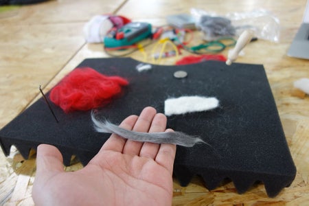

I got the conductive fibers from Sparkfun. If you can't find any but have access to conductive yarn, just take a piece of conductive yarn and unravel it until it turns into fibers. Or keep it in its yarn form and felt it into the piece of fabric you'll be making.
Wool fibers and felting needles may be difficult to find, but are often available in craft stores or online.

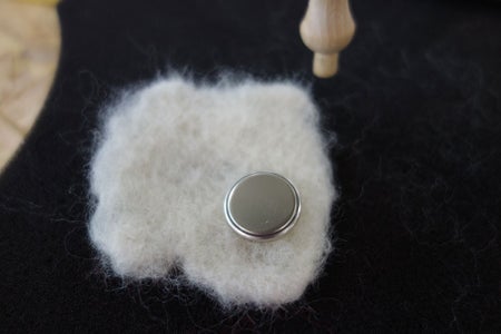

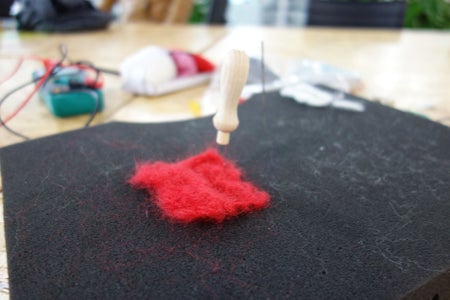

  1. Pull out a tuft of fiber from your wool roving. Don't cut the roving using scissors as this will create blunt ends that won't felt very well. Just hold your wool roving gently and tug at one end.
  2. Lay out your tufts of fiber on a piece of foam width-wise. I'm using a soft foam material used for the packaging of electronic equipment. Some people like to use styrofoam.
  3. Lay out a second layer of fibers, this time length-wise to create a cross-hatch for the fabric. For thicker fabric, you can continue to layer fibers, alternating directions.
  4. Once the fibers are placed on the foam, take a felting needle and stab the fibers into place at the corners.
  5. Continue stabbing the fibers all over with the felting needle. The fibers should become less and less fluffy, matting themselves to each other creating a more flat material. This step might take a while.
  6. When the fibers look like they've started to mat together into one whole piece, flip the felt upside down and continue stabbing.
  7. If you see any holes appearing in the felt, take a tuft of fiber, lay it on top of the hole and felt it closed.
  8. Create two pieces of felted fabric in different colors. I like to use red for positive and white for negative.

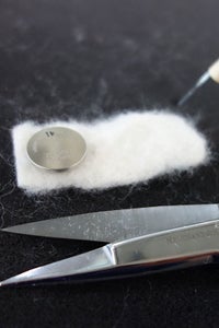

  1. Place the battery on the pieces of felted fabric and cut them into the appropriate sizes for a battery holder. Remember to measure twice, cut once.

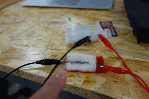

  4. Test the conductive material with a multimeter, making sure that it is conductive from one end to the other.

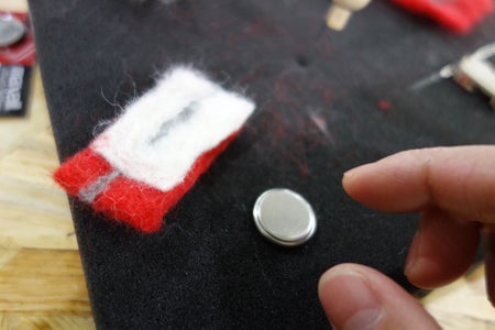

Step 3: Felt Together a Battery Holder
Once the fabrics are felted with conductive materials, you're ready to felt them together to create a battery holder.

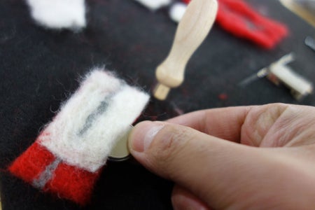

  1. Sandwich the 3 volt battery with the felted fabrics. I like to leave a little overlap so I can see the two colors from either side of the battery holder.
  2. After you figure out the placement of your battery, insulate the inside of the battery holder so that only the center of the battery touches the conductive fibers by placing more of the non-conductive wool fibers in between the two fabrics you created. This method is hard to explain, and you can potentially mess up by covering too much of the battery or not enough of it. Use the multimeter often to check whether the battery connects with the fabric or not, and that the two pieces of fabric are not short circuiting each other.
  3. Use the felting needle to felt the two pieces of fabric together. You can felt the battery right into the holder, or leave an opening up top. Keep testing with the multimeter to make sure the conductive materials are still connected, and just as importantly that the two sides of the fabrics are not connected to each other.
  4. Because of the nature of felted conductive materials, you can tightly felt the battery holder together to create a permanent connection. Or you can loosely felt the battery holder to create a simple switch. With the second method, there won't be a connection unless the battery holder is squeezed.
