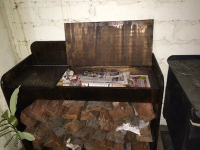

7. See picture. measure and cut 900mm down to fit inside back of cupboard. Measuring this after fitting will ensure that it is the right height to fit the lid. Glue and nail from behind and below
8. Cut two side inserts and fit tightly then nail from below. This will complete the cupboard assembly.

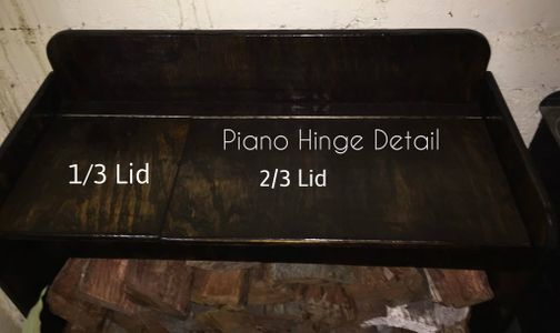

Step 3:
1. Easiest way to construct the lid is to join both parts together during the cutting and hinge fitting. This ensures that both parts are flush at the front and sit well.
2. Join both parts of the lid using a piece of scrap. Ensure that this does not stop lid from sitting flush on top of cupboard.
3. Cut 40mm strip off the back of the lid.and join strip back on lid using a 900 mm piano hinge or similar.
4. Sit lid on cupboard and decide on overhang. I used 30mm (1 1/2") but more or less is fine depending on your existing furnishings. You might like a flush finish and add handles on the front or top. 30mm gives the same recess as the bottom of the box.
5. Glue back strip to back of cupboard lining and back nail.
6. Allow glue to dry for about 20 minutes then remove joining strip.
7. Finish to match your furnishings and add a strip of felt under the lids to create a soft close.
Install the box and fill. Good luck with your project.
