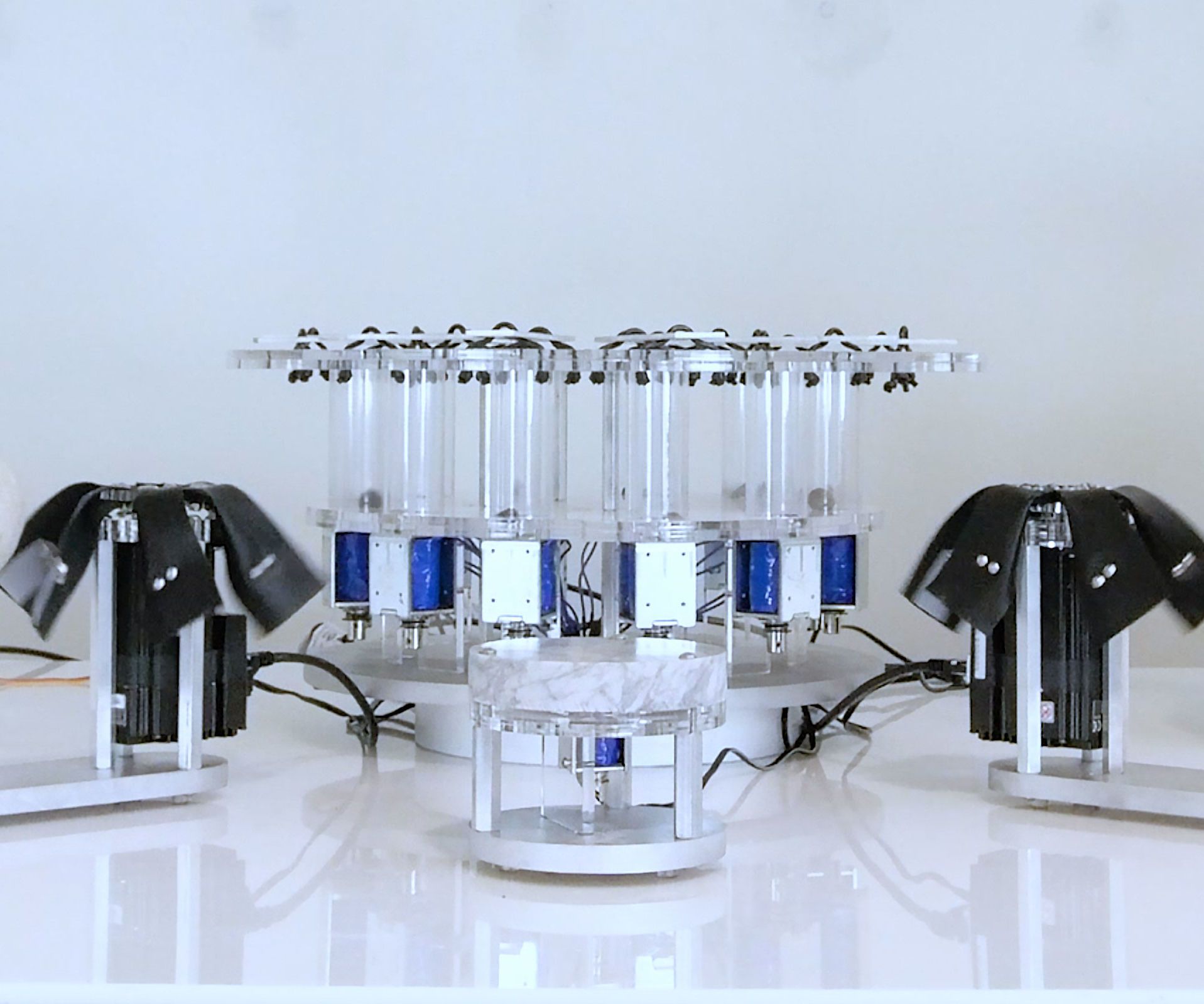

Humans have been destroying fish habitats for many years through activities from trawling the ocean floor to filling it with plastic. With the advent of the fish hammer, fish can now wreak destruction on mini human habitats. The project was created at Autodesk's awesome Pier 9 digital fabrication workshop as part of their artist in residence program.
This Instructable will show you, in detail, how to construct a track-based curvilinear motion system. These systems are the most common type of drive mechanism for fish hammers (the part that makes the hammer move around the aquarium). However, the same mechanism can be employed to move anything along a curved track. For example, a motion control system for cameras.
If you do decide that you want to actuate a fish controlled hammer rather than any other object, below is an overview of some of the things that you might need to consider...
Fish Welfare
A fish is for life not just for an art show so don't build any fish hammers unless you have the time to take good care of the fish. Among other things, this involves treating the water so it is habitable, cycling the water to keep it clean and of course, feeding regularly. Thanks to Sherry Wong, Pier 9's in house aquarium expert for answering my unending stream of fish-related questions.
Fish Choice
The first fish that I chose for this project was a Siamese fighting fish (or Betta fish) named Smashie Sr. As a novice fishkeeper and first time fish hammer builder, I assumed that a fighting fish would naturally enjoy smashing stuff. After a couple of days hanging out with Smashie Sr, I became aware that he was more into meditating in the corner of his tank rather than high energy activities. Luckily, Vanessa Sigurdson, courageous leader of the AiR program, came to the rescue and agreed to adopt Smashie Sr. After confusing some aquarium store owners with questions about fish temprament, I settled on a goldfish, Smashie Jr, who was the perfect mix of outgoing, energetic and conveniently brightly coloured for computer vision.
Interior Design
Fish can be very sensitive to interior design faux-pas. They are also surprisingly in tune with what patterns are popular this season. When deciding on how to furnish your fish hammer smashing area, be sure to get furniture and flooring that complement your fish's skin tones.
Software and Electronics
The software was written in C++ using openFrameworks.
The computer vision was done using OpenCV. To track the fish the camera feed is converted from RGB to HSB colour space and then is thresholded based on ranges for the hue, saturation and brightness. In order for this to work effectively, you need gravel and tank decorations that contrast with your fish.
The next task was to work out how to control the motor smoothly. The motor is designed with industrial processes, rather than fish control, in mind where each movement is known in advance. In order to get around this, I put the motor into jog mode, controlling its speed rather than its position, and wrote a PID controller that controlled the speed of the motor based on the encoder position.
A Teensy microcontroller is used to read the hammer position sensor (a Hall effect sensor on the cam), control the hammer stepper driver and tell the computer over serial when the carriage should be stopped (when the hammer is down).
