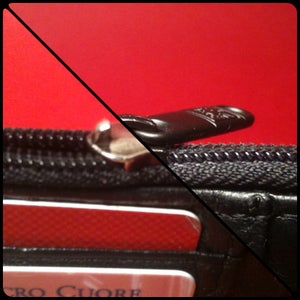

In order to remove your old and broken slider you have to cut the slider stop.
Once you did it you can insert the new slider and you can check if the teeths are closing in the right way.
If it's all OK like in photo #6 you can go to the next step ;)

Sew 10/15 stitches across the bottom of the zipper where the preexisting stop used to be.
Burn the thread's end to make it more resistant and try if it does his job :D (see photo #7)
