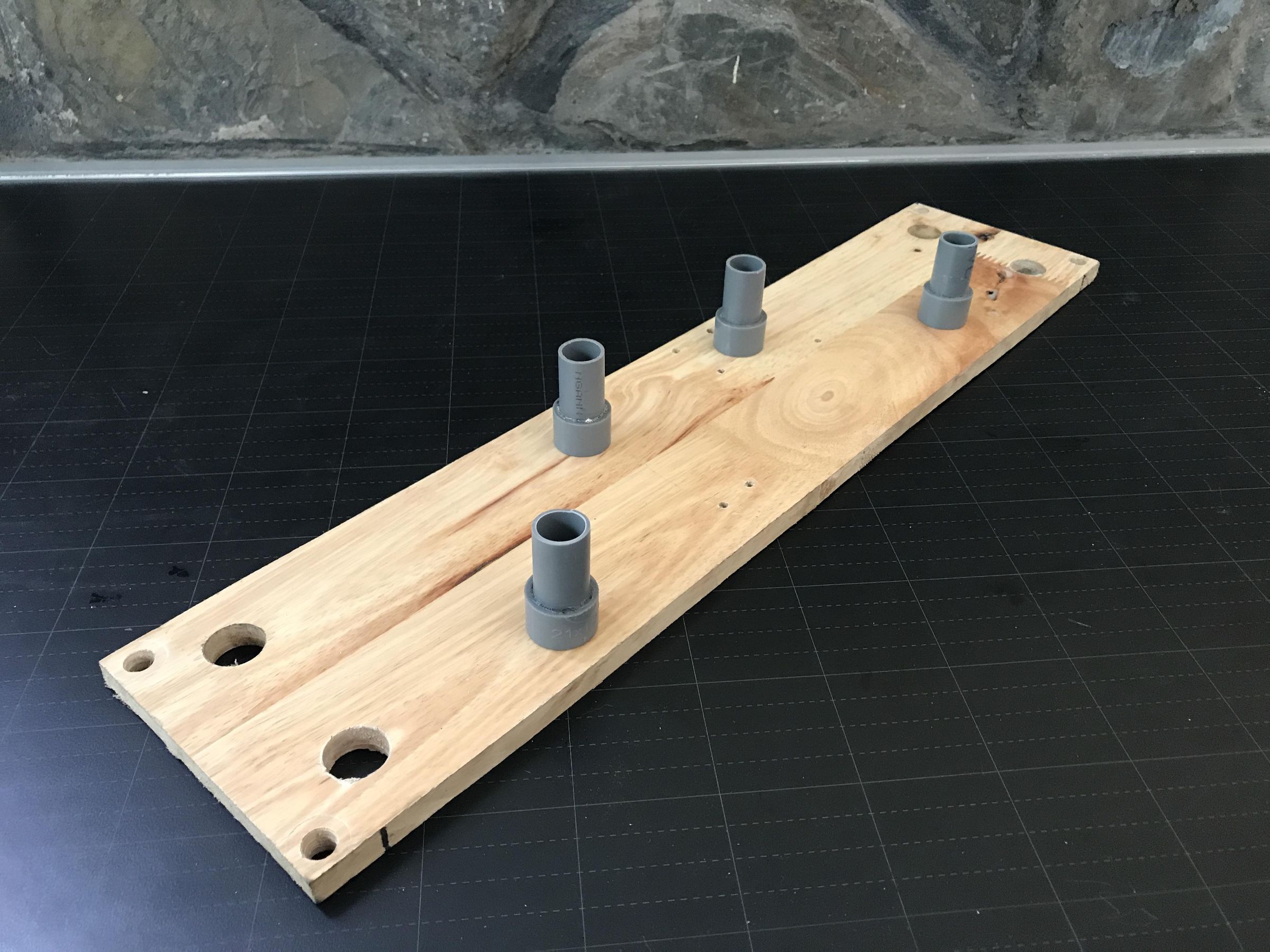

Step 1: Build a Base
I connected 2 pcs x PVC four way tees, put 2 end caps at 2 open holes and drilled on these end caps 2 holes diameter 8mm for linear shafts.
Wooden plate was drilled 4 holes Ø22mm following the holes on the bove assembly and length of linear shaft 500mm.
I installed 2pcs x assembly four way tee to the wooden plate holes.
Two linear shaft 8mm was installed and did alignment.
