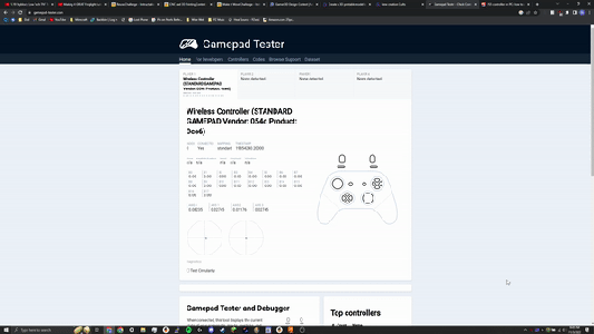

Using gamepad-tester.com I can see that the left stick has drift on the horizontal axis.
