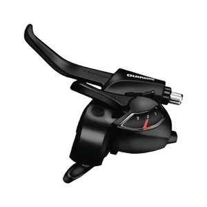

In this Instructable I'm going to show you how i dissasembled, fixed and then reassembled my Shimano Tourney ST-TX800-L lever. This might work on similar indexed shifters too.

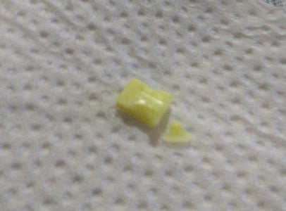

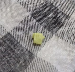

I first noticed my shifter was broken when i tried to shift into a larger front ring by pushing the lever and it didn't do anything. The problem was that two of these tiny plastic parts had split into two pieces each. In the two pictures you can see one of the broken parts, before and after being glued back up.
To fix this I:
  1. cleaned them with soap and water in a bowl (I would advise against doing it in a sink because the parts are tiny and might slip and fall down the drain)
  2. Super glued each plastic part with it's split piece.
  3. Found out the root cause of the issue which was a kink in one of my shifter cables causing it to be wayy too hard to pull. I solved that by straightening it with two sets of pliers and then greasing the cable up, however, the ideal solution would be to replace the whole cable.

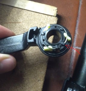

In the picture you should be able to see how the lower shifter should look like before being re-inserted.
Things to note:
  • There's a hole for each yellow part to go into, where they can pivot
  • The lock ring holds them up by that little lip they have on the top
  • The lock ring is not a full circle, and it has a hole which matches with a solid part of the lever (pointed at by the red arrow)
  • When pushing the lever into place, push the shifter from the top side to make the screw in the middle stand out (i didn't do it during the video and that's why i found it so hard to close everything up).
