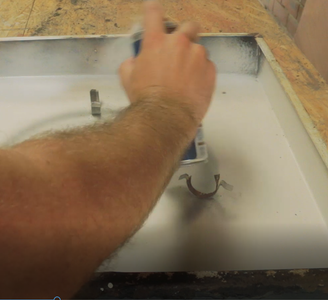

Step 3: Step 3: Paint All the Things!
Bob ross would be furious, but I used some spray paint to bring back the old colours.
The black frame got a new coat of black and the inside was repainted white, since the rain had done some damage over the years.
The old lights will be replaced by a continous LED strip that will snake its way through each lightbox. So I drilled an entry and exit hole in the back of each box for the strip to fit through.
Then using a file I made the opening wide enough and smooth it out so it does not slice through the LED strip.
