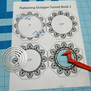

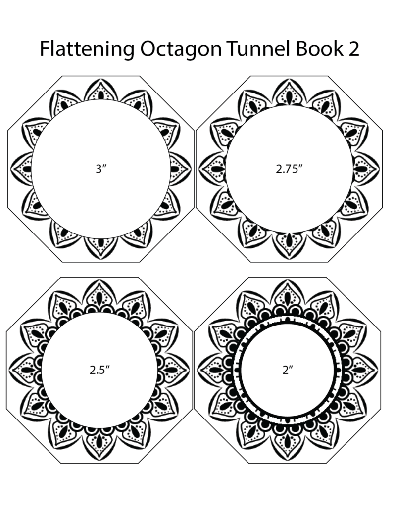

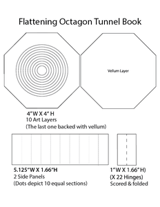

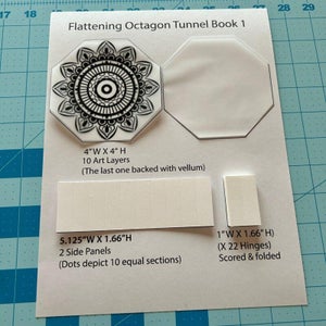

To make a book like mine, you’ll need to create 10 art layers and one Circuit Layer that are the same size and shape. Each art layer should have circles that decrease in size removed from their centers.
You can do this by creating your own artwork, or you may print my templates and use circular dies or a craft-knife to remove the centers.
I’m using 10 octagons that are 4” W x 4” H. I’m also adhering a layer of vellum the same size directly behind the last art layer to diffuse the light. I printed my art image directly onto the vellum, but a plain piece works.
Each art layer will be separated by two paper hinges (4” H x 1” W) that are folded in half. Cut and fold 22 hinges and press them flat with a bone folder.
The hinges will also connect to two flat side panels that will add extra stability to the book. Cut two sides measuring (5.125” W x 1.66” L).
I’ve included a PDF of the cut file for the basic parts, in case you’d like to use or adapt the design with your own artwork.

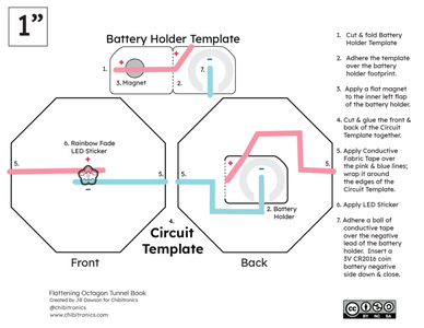

Print the Battery Holder and Circuit Template onto a piece of cardstock, or use it as a guide. If you don’t wish to use a magnet, skip that step.

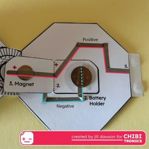

  1. First, cut and fold the battery holder template.
  2. Next, adhere the right flap of the battery holder template over the footprint that matches it on the Circuit Template.
  3. Third, adhere a small flat magnet over the circular footprint on the left flap of the battery holder.
  4. Fourth, cut out the front and back sides of the Circuit Template and glue them together to create one layer.
  5. Fifth, adhere Conductive Fabric Tape over the pink ( + ) and blue traces ( – ). The conductive tape should wrap around the edges of the circuit template and overlap the magnet.

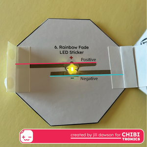

  6. Sixth, adhere a Rainbow Fade Animating LED to the template and reinforce it with patches (or pieces) of conductive tape.
  7. Seventh, adhere a ball of conductive tape over the negative lead of the battery holder, and adhere the battery to it with the negative side down. If you did not opt to include a magnet under the positive trace, adhere a second ball of conductive tape on top of the positive lead of the battery holder when you want your LED to be turned on.
  8. Lastly, test the circuit by closing the battery holder flap.

Placing a piece of double-sided tape under your battery (but not over the conductive traces) is an additional way to help keep the battery in place. Additionally, adhering the ball of Conductive Fabric Tape directly on top of the negative trace will increase the physical and electrical connection between the battery and the rest of your circuit. If you did not include a magnet, adhering a ball of Conductive Fabric Tape directly on top of the positive trace will help hold the battery in place, while increasing the physical and electrical connection.
