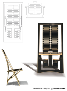

I've been fascinated by Gregg Fleishman's CNC chairs for years: such a clever idea, to carve from a single sheet of plywood a fully functional chair, with effective cushioning and back support, not to mention tremendous style. Having gotten some ShopBot training, and in search of a project to make use of that training, I chose Fleishman's Lumberest chair as a good intro to that machine and to subtractive manufacturing in general.

The first thing I did with the file was to open it up into Adobe Illustrator, this is my vector drawing app of choice but you could also use Inkscape, AutoCAD or any other vector software that can import DWG files. Once I had the file open I got rid of any of the vectors that I didn't want to cut (such as text labels and bounding boxes).
I made my artboard 48"x48" as I knew the plan was to cut this out of a 1/2 sheet of plywood. Then I positioned the two parts on the art artboard to make sure they would fit…. It was tight but they did fit.
As this was not my design I needed to see what size router I needed to make the cuts, there were some pretty tight slots and using the measuring tool in Illustrator I measured the narrowest one. It looked like a 1/8" router bit would be a good size.
The next task was to make the tool paths. I use vCarve Pro for creating my paths, it's pretty easy to use and it's also what is installed on the ShopBot at TechShop so if i need to make any changes my files will open no problem. (This isn't an Instructable about how to use vCarve as there are plenty of tutorials out there.) I created 4 profile tool paths in total, 2 for the smaller piece and 3 for the larger piece. The reason I did 2 was that I wanted the outside cut to cut on the outside of the vector and the inside piece to cut on the inside of the vector.
When I first previewed the profile cuts the preview looked incorrect, it seems like some of the slots in the file are slightly less than 1/8" so vCarve wouldn't send a 1/8" bit up there. A simple hack to solve this issue was to tell vCarve that the bit was only 0.120" in diameter. This was only a tiny difference (1/8" is 0.125") but it totally worked.
