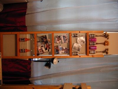

Step 1: Gather It Up!
Get in your car (or better yet on your bike or go by foot!) and go to Home Depot. Then, get a basket and gather these things.
*NOTE* you may want to look ahead to the final steps and decide how you want to use your board before going to the store.
Materials needed for basic construction:
-The mesh--1/4" hardware cloth
(the smallest size you can get is 2'X 5'. That is sufficient.)
-4 rod coupling nuts (5/16"-18 x 7/8")
(the package only has 3... Sorry, you have to buy two packs.)
-4 pan head phillips screws (#10 x 2")
-8 washers (1/4 SAE washer)
(the size of the washer isn't that important, just make sure that the screw fits through the washer and the head of the screw will be larger than the hole in the washer.)
-1 nail
(pretty much any nail that is a good bit skinnier than the screw will do. It's just used to make the pilot hole for the screw.)
-a pencil
-a friend for step 6
Things to gather up at home:
-gardening shears or some sort of wire trimmers
(I have used scissors before to cut the wire, but it is a little more difficult.)
-drill
-phillips head screw driver bit
-hammer
-yard stick
-level
Step 2: Prep the Mesh
Open up the package of hardware cloth (wire mesh). Usually it is tied up with some wire--use your wire cutters to snip this wire until you can unroll the mesh.
We are going to cut a piece that is 2ft x 18". Since the mesh is 5ft by 2ft, we are going to use the existing 2ft width and make a cut 18" into the 5ft length. The mesh will want to stay rolled, so weigh down the edge with some heavy books. Now that the mesh is secured, measure out 18" of mesh.
Grab your wire cutters to cut the mesh. Cut the mesh along the wire line that is closest to 18". **The wire is VERY sharp after you cut it, so keep your fingers away from it.** Make sure you are cutting as close to the wire line as possible so as not to leave any prickly pieces of wire along the edge. (see image)
Now you should have a free piece of 18" x 24" mesh. The mesh will probably roll up. Try to roll it the opposite direction to bend it into a somewhat flat sheet. It doesn't have to be perfect.
Step 3: Measure It All Out
Okay, our piece of mesh is 18" x 24" the screws that will hold it into the wall will be placed 2-7/8" into each corner. That means 2-7/8" horizontally from the corner, and 2-7/8" vertically from the corner (see the drawing).
Once you decide where you want to place your floating mesh piece you will need to mark it out as follows. Start by making one small light pencil mark to indicate where the top edge of the mesh will be. Then measure 18" down and make another mark. Now measure down 2-7/8" from the top mark and make another light mark. Then, Measure up 2-7/8" from the bottom mark and make another mark. You can now erase the first two marks you made. Place your level horizontally at the top mark and draw a light level line that will function as the top green line in the first image below. Now repeat with the bottom mark.
Now you need to make the vertical lines. Measure out where you want the 24" width and make a mark at each end of it on the top line. Measure 2-7/8" to the right of the left-most mark and make another mark. Measure 2-7/8" to the left of the right-most mark and make another mark. Place your level vertically and draw a vertical level line for each of the marks. These lines will serve as the vertical green lines in the first image.
You should now have a rectangle just like the green one in the drawing! Measure the difference between the top and bottom line. Make sure it is 12.25" Then, measure the difference between the left and right line. It should be 18.25"
Now erase the lines leaving only little plus signs at each corner of the rectangle.
Step 4: Nail Time
You will now create pilot holes for the screws. Hammer the nail into the center of one of the X's. Be sure to keep the nail as close to perpendicular to the wall as possible.
Pull the nail out now and repeat the process for each of the X marks. This should leave you with four holes.
Step 5: Screw Prep Work
First, you have to understand how the screw and bolt combination will work. Look at the first picture to understand the order. It should go like this:
screw head, washer, mesh, rod coupling nut and then another washer then the remainder of the screw will screw into the wall.
Grab your Sharpie. You will end up having four marked squares to indicate where the screws will go in the mesh. You are going to mark the square that is 12th from the top or bottom of each corner and 12th from the left and right of each corner (see picture #2). When you measure vertically and horizontally in from each corner, the center of that marked square should be 2-7/8"
Step 6: Screw It In!
Now you should have the mesh marked where the four screws will go and have four pilot holes in the wall.
Plug your drill in and get the phillips head bit locked in place. Grab a buddy and have them hold the mesh in place so that the marked squares line up with the pilot holes. Thread a washer on to your first screw, and then put the screw through the mesh in the marked place. Place a coupling nut behind the mesh and then another washer behind that see image to make sure you have it right). Now, with your friend holding the mesh in place, set the point of the screw in the pilot hole, make sure you are holding the drill level and screw that sucker in!
*Be careful not to keep drilling after it is tight because it may strip the dry wall.
*If you hit a stud it will be more difficult to screw into. Make sure you apply enough pressure into the drill to keep it from stripping the screw.
Repeat this until all of them are screwed in and then you should have yourself a floating wire mesh thing to use however your happy little heart pleases! :D
