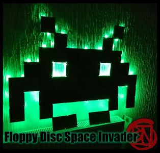

In this instructable I am going to show you how to upcycle a bunch of floppy discs into (in my opinion) pretty cool wall deco.
Now I need to note that I intended to make this from materials that would mean no specialist tools were required, there are ways that this could be made sturdier and I made some adjustments on the fly but I will obviously share what I did.

First of I measured out a square of correx that would pit my space invader (11 wide x 8 high). Now it's important to note that floppy discs are not a perfect square and are in fact slightly rectangular so be sure to keep them all on the same axis when measuring out. the also have one corner cut off but that will actually come in hand later.
From here I laid out my disc to get the shape of the space invader. Important note that will help you out, for the "antennae" and the middle legs where they line up diagonally I made sure to sue the small cut off corner at those points so that they could be attached to the main body and not have to be separate parts.

Flipping the board over and going round the edges I then taped the lights in place. I started from the middle of the bottom and worked my way around, cutting into to the eyes from the antennae. This was a 33ft set of lights and I ended up with a bit extra so i just kept going around the eyes to make them brighter.
I then attached the battery pack/receiver at the bottom with a bit popping out so that the remote could still reach it. Important note, if using battery operated lights, ensure that when attaching it you can still get access to the batteries
After the lights where in place I looped some of the hanging wire through the eye holes, making sure that it wouldn't hang above the body or get caught on the lights.
Then i flipped the board back over and glued the discs into place.

As you can see from the photos and video what was one a bunch of outdated plastic is now a cool wall decoration. I have also put a pick of the layout of a smaller Space invader.
