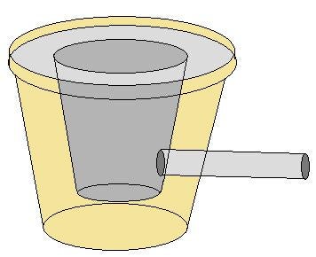

I started with a large terracotta pot (800 mm diameter) and drilled and chiseled a hole in the side for my air intake pipe. The steel pipe that I used was an old piece of steel tube fencing that I had lying around on the farm. What you are looking for in a steel pipe is something that you can attach to the outlet of your vacuum cleaner. I had to make a custom connection for my vacuum as it didn't have any. Oh, and the vacuum, I bought as a second-hand throw-away for $5.
Mix the fire-clay, cement and perlite together in a large tub (or in a wheelbarrow). The mix that I used was 1:1:5 fire-clay, cement, perlite. The dry mix was turned over and thoroughly mixed together. Make a well in the middle of the mix and add in about 3 liters of water until it is a stiff mortar-like mixture.
Put about 3" of mixture into the bottom of the pot (to the bottom of the air-hole) and pack it thoroughly. I used a steel rod to pack it down and make sure that I got all of the air bubbles out.
Put the plastic pot into the center of the terracotta pot and put your air pipe into the hole. Pack the wet mix around the air pipe ... again, avoiding air bubbles.
Keep adding more of the mix into the void between the terracotta pot and the plastic pot while packing the mix as you go.
Bring the mix up to about 2" from the top of the terracotta pot and smooth it down as much as possible.
