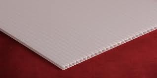

Coroplast - 5 sheets, 4mm thick, 4 x 10 feet, white (Regal Plastics, Austin, Tx)

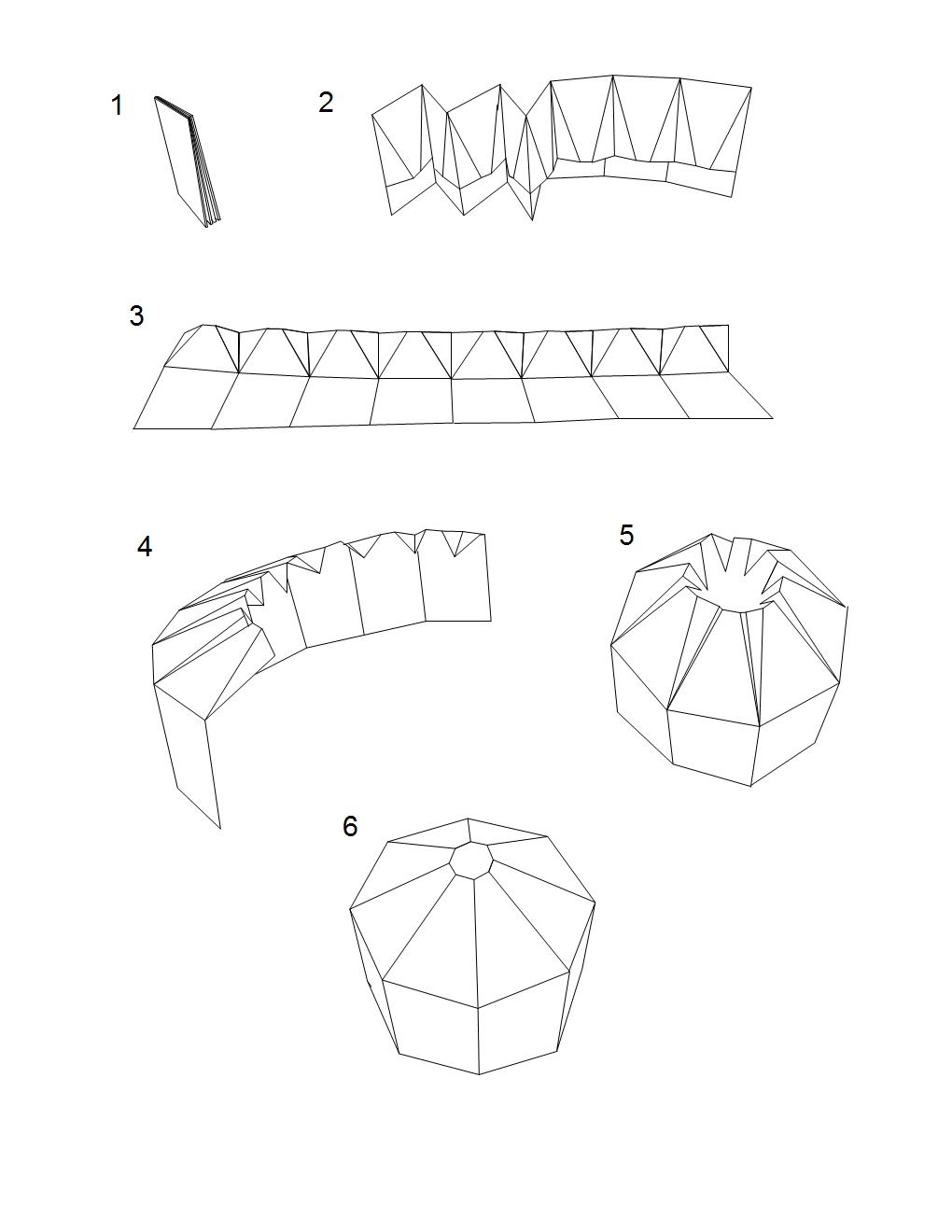

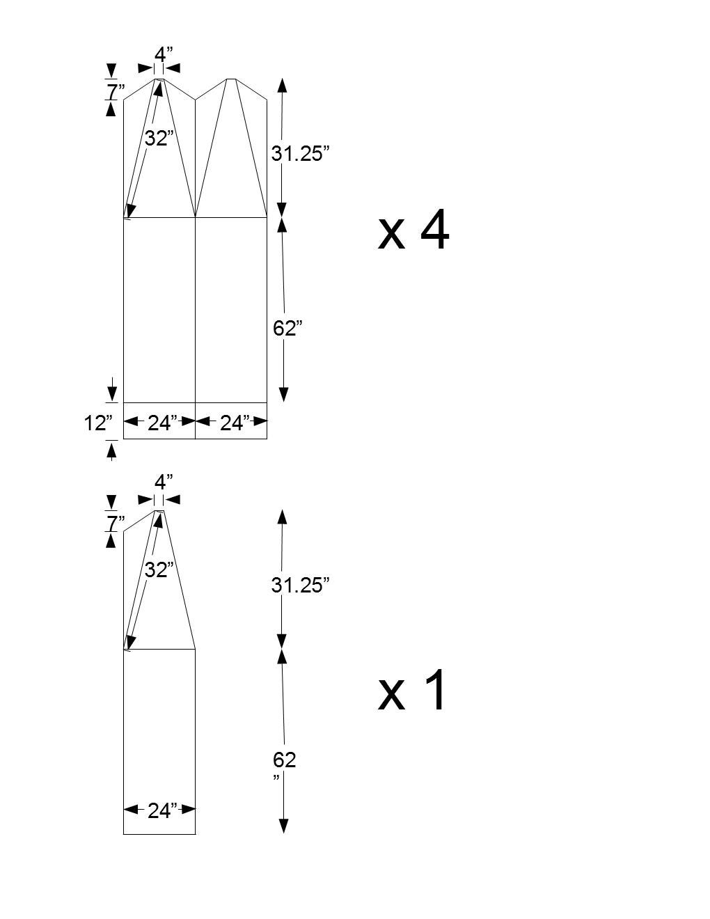

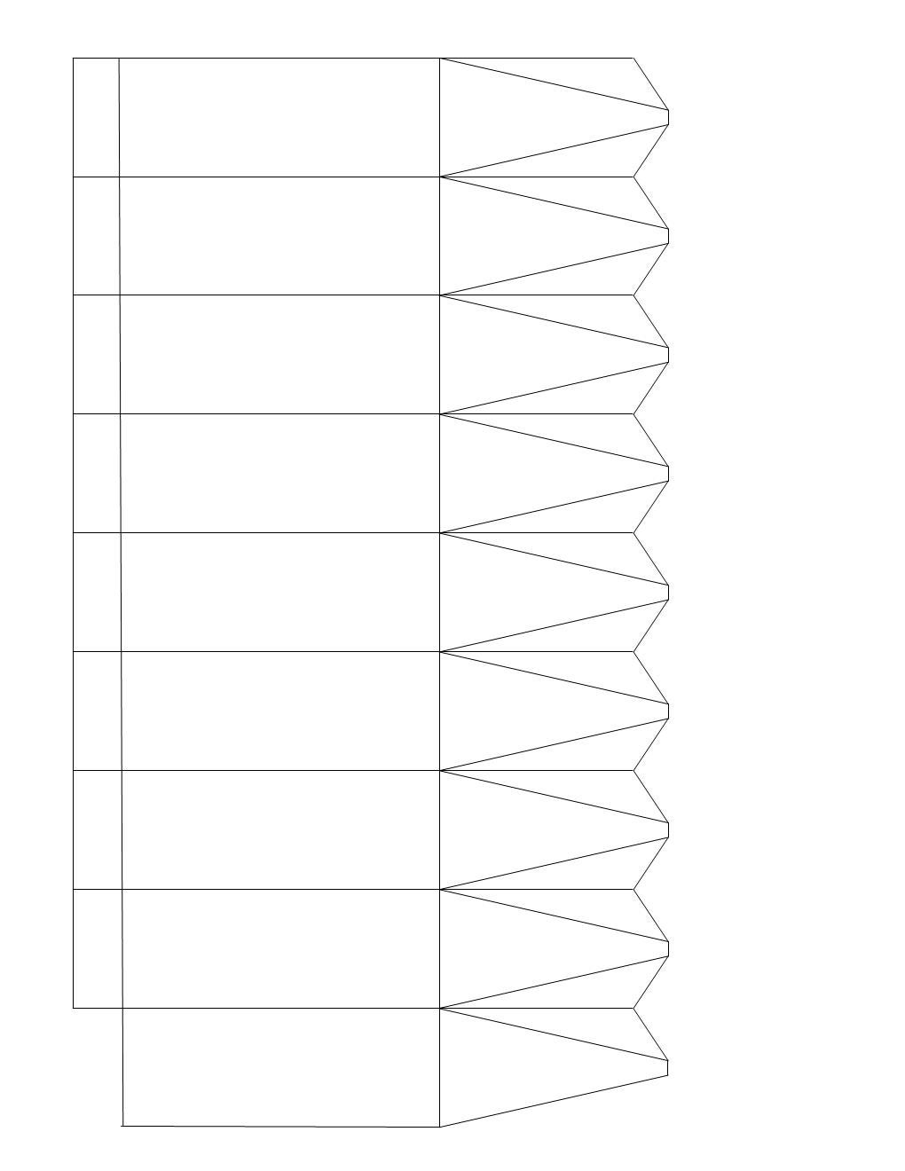

Step 3: The Pattern

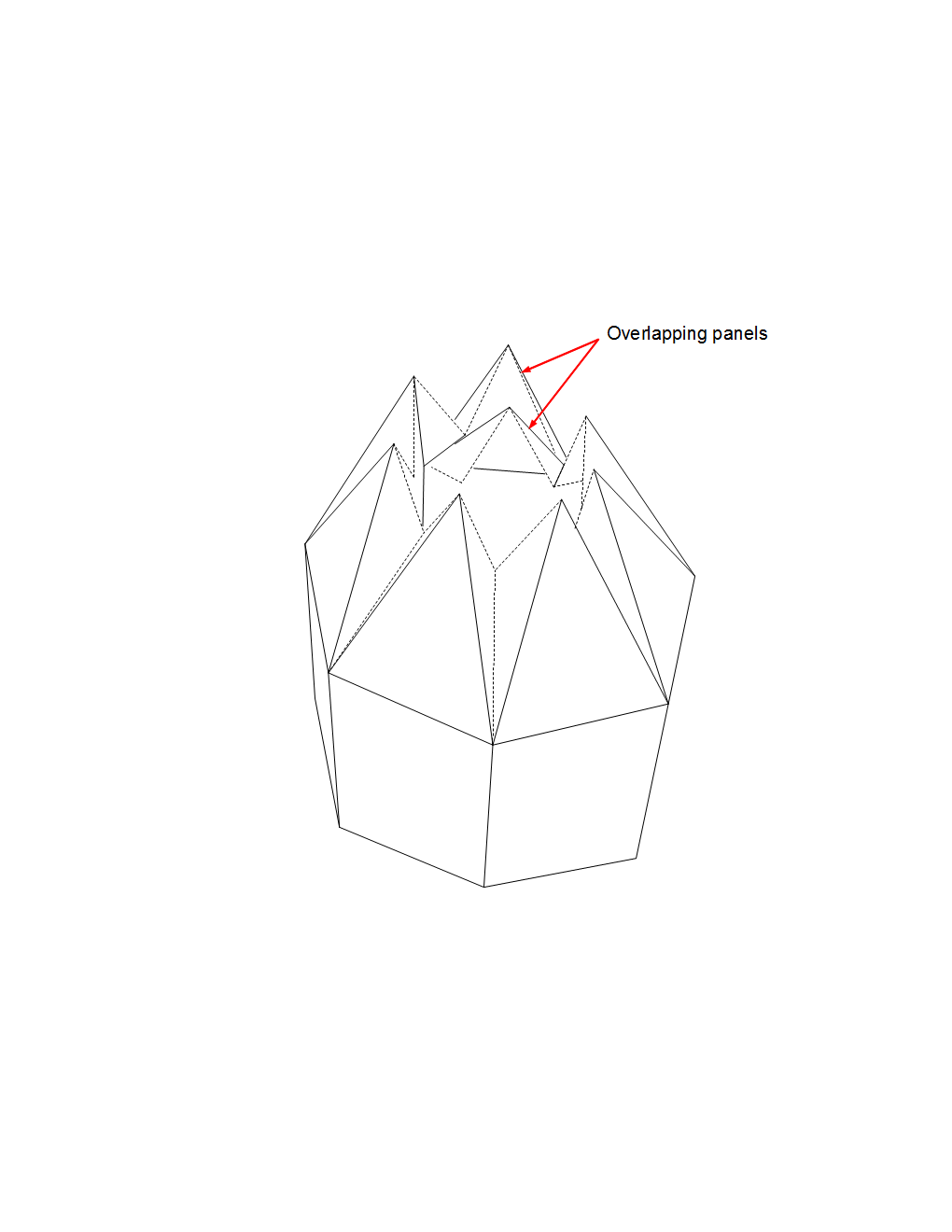

Here is the pattern for the entire structure. This pattern will be achieved by cutting, scoring, and taping together the 4 1/2 sheets of Coroplast. It is a good idea to experiment with the structure by printing out the pattern on a piece of paper or card stock. Then practice folding and unfolding the structure as shown in the diagrams. You may discover alternative designs that are better suited to your purposes. For example, seven or six sides instead of eight. Experiment with it! Notice how the end panels overlap so the entire roof will shed rain water to the outside of the structure.
Step 4: Drawing the Pattern

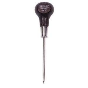

Draw these patterns on the Coroplast sheets; four sheets for the top pattern in the diagram, and one for the bottom. The sheets of Coroplast are the same on both sides, so it does not matter which side you choose to draw on. To cut down on the amount of tedious measuring and drawing, I used one sheet as a pattern for the rest, by stacking sheets under the one that is already drawn and marking the outside endpoints with a Sharpie marker, and the inside points by sticking a hole through the sheets with a sharp tool like an awl or nail. Use acetone on a rag to erase marker errors.

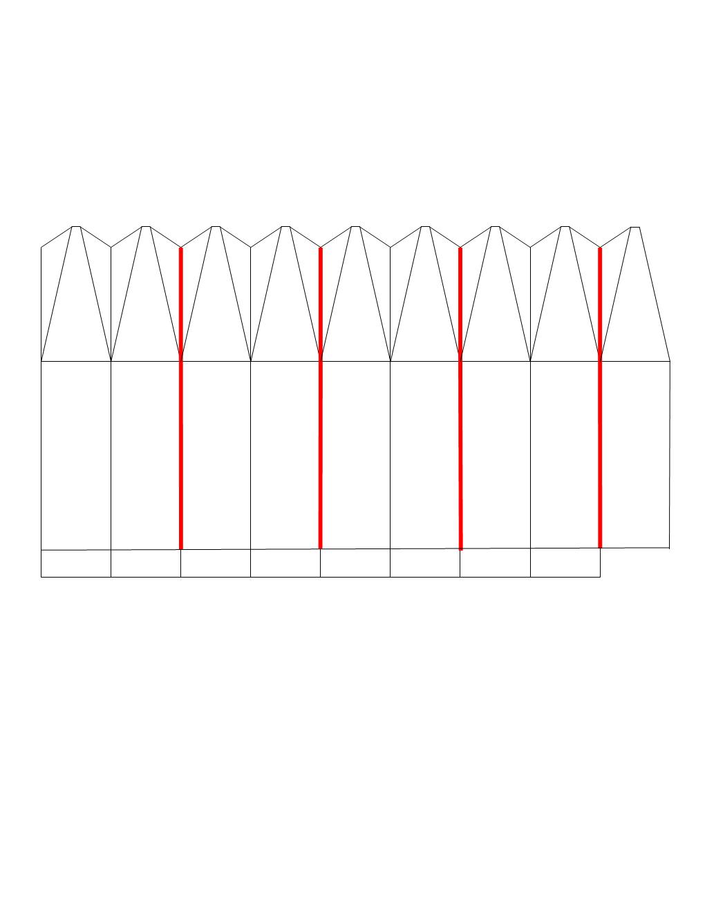

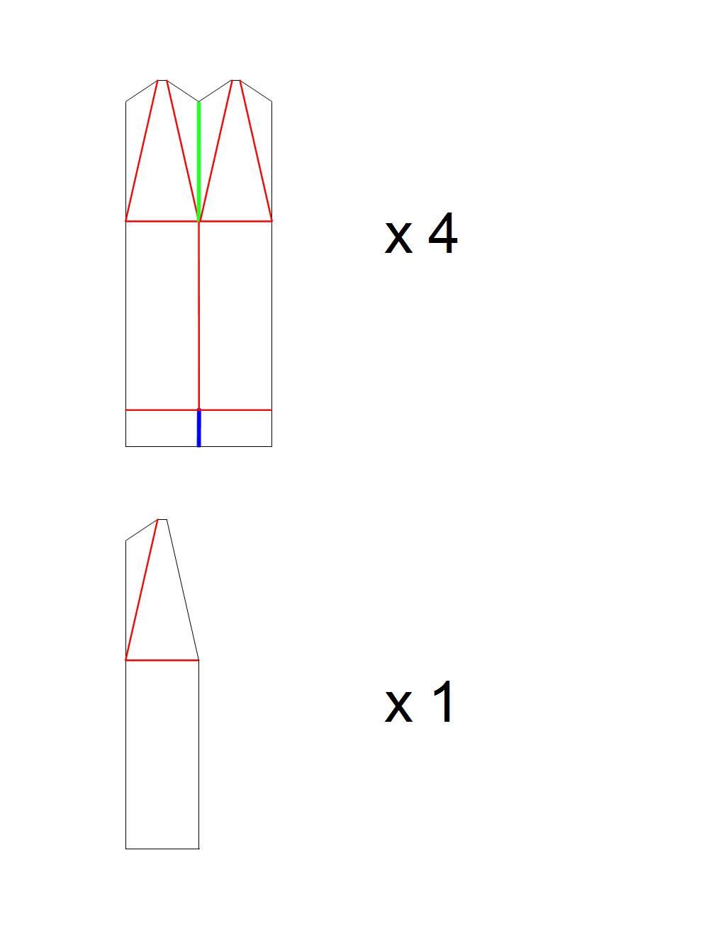

Step 6: Scoring the Fold Lines
Scoring the sheets makes them easier to fold along straight lines. By scoring, I mean to cut through the first layer of one side, leaving the opposite side intact. Adjust the utility knife blade to a depth of around 2mm. Make test cuts on scrap material to practice and see how deep the cut needs to be for a good bend in the material. The metal ruler helps as a guide when cutting at a diagonal across the sheet. Also the orientation of the ruler with respect to the cut and the internal ribs of the Coroplast is important. One orientation pushes the blade against the ruler (good); the other orientation pushes the blade away from the ruler (bad). Experiment to find the method that works best for you.
The red lines in the figure are scored on the outside (the side with the drawn lines). The green line is scored on the inside. The blue line is cut all the way through. Bend all the scored lines to loosen them up.

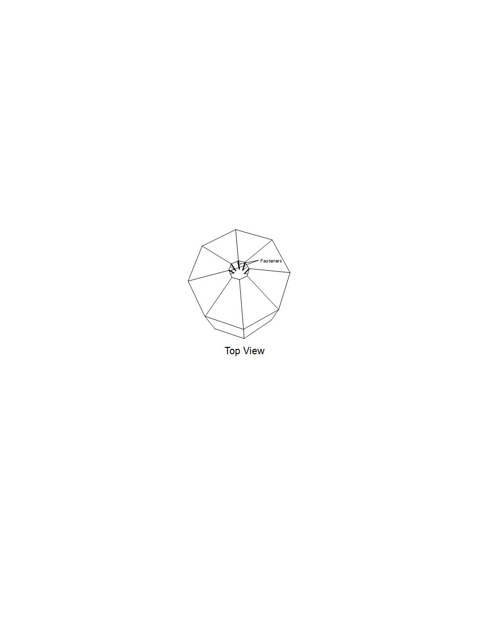

Set up as shown in the diagram steps 3 - 6. The bottom floor flaps are not shown in this diagram, but they fold to the inside of the structure. Also missing the overlap section in this diagram, which may overlap on the inside or the outside. Use 8 binder clips to secure the structure at the top as shown in the 2nd diagram. Tape the overlapped panel on the outside to secure it until the PVC bolts are installed in the next step.

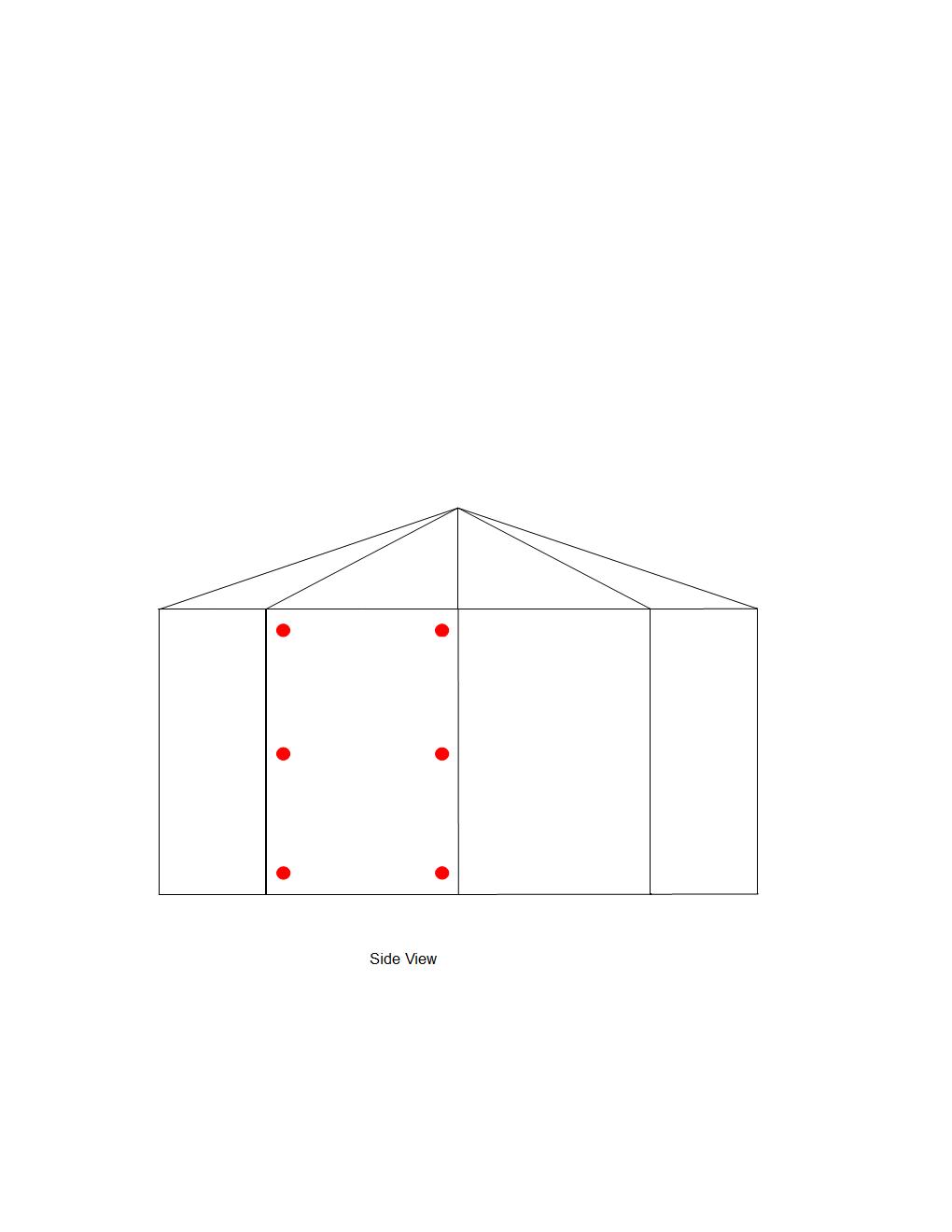

With the overlapped wall sections lined up and secured with tape, drill holes through the overlapped walls as shown in the 2nd diagram. Insert the PVC bolts and tighten. This action is easier with someone on the inside and the outside, since the door shown in photos is not cut yet.
