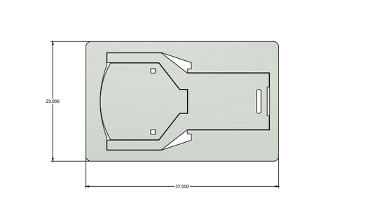

Step 1: Dimension Drawings
a. If using the CNC router, either download the CAD file below, or draw your own with desired dimensions.
b. If using a jigsaw, make your own drawing of the chair, using the pdf. attached below.
Step 2: Cut Out the Chair
a. Cut out the chair using the CNC router, using a 1/4 inch bit.
b. Cut out the chair using the jigsaw. Try to get as close to 1/4 inch margins as possible. It helps to trace an outline of the chair on the plywood first, using the drawing's dimensions above.
