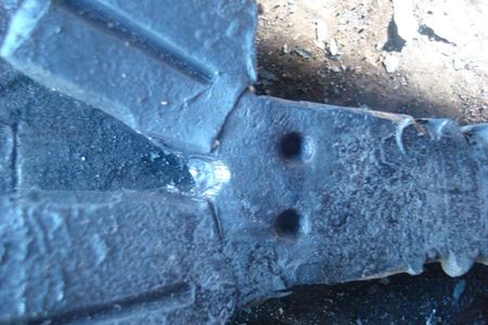

Split the flattened head partially down the middle. Then use the chisel to cut a groove down the middle of each little "wing" . If I confused you here, look at the pics.
Step 5: Embellishments
use a small punch to punch in the eyes. Then use a flat tipped round punch right at the end of the cut from splitting the claws, this will give almost a little beak look when you bend the claws.
Now you heat the head, and using pliers, twist them around so the groove is facing out. and bend them out a little until they look nice. take a little time and mess with them till they look good.
