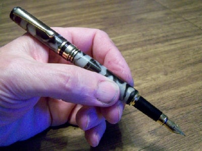

The pen shown is from a Classic American kit sold by Woodcraft.  The pen is reminiscent of a Parker Duofold from the late 1920's and early 1930's.  The color pattern is very similar to one used on Duofold pens.

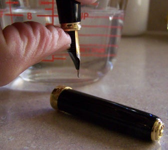

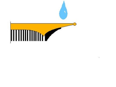

Step 1: Making It Flow If Dried Out
A couple of Instructables advise soaking the nib and feeder (the section) in cool water for a day or so to remove old dried ink from the ink flow path or capillary system. Actually, a good flushing of the capillary system like this is advised every month. Another good practice is to add a little moisture to ink held in the nib and feeder that may be partially evaporated after a few days of non-use. Get a drop of water on your fingertip and touch it to the slit between the nib's tines.  If the pen has been sitting unused for more than a few days, add two or three drops of water,  Let it soak in. If you do not write with the pen immediately, the water can mix with the ink under the nib more thoroughly. Do this once a week and as necessary.
In more severe cases, as when ink has been left in a pen during several weeks of non-use, cup your hand under a faucet and fill it with water. Quickly dip the whole section into the water in your hand and remove it. Cap the pen and carry it in your pocket for an hour or so before using. If the writing is light in color, touch a facial tissue to the nib and feeder a few times to remove excess water or watery ink.
Fountain pens like to be used regularly.  If you are not going to use a pen for a while, empty the ink from it and flush the pen with water until no discoloration from ink appears.

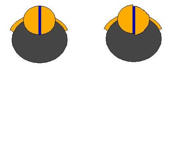

A magnifying glass of about 3x to 5x is a big help when tuning up a fountain pen. The drawings below are a little out of proportion for the sake of illustration. They show a fountain pen as viewed from the end of the nib. The left portion shows a pen with properly aligned tines. The two halves of the iridium ball are aligned and the pen will write smoothly. The pen on the right may have been dropped or mishandled. For whatever reason, the halves of the iridium ball at the tip of the nib are out of alignment. The pen will scratch  as it moves across the paper. With your fingernails press down on the high side and upward on the low side. Check your progress often with your magnifying glass. If the nib is stamped from steel, it should respond well to pressure from your fingernails. If it is a springy steel, it is designed to flex with varying pressures from your hand and add expression to the varying width of your strokes. Springy steel is also more difficult to press into a new shape. (The blue center is ink waiting to flow.)

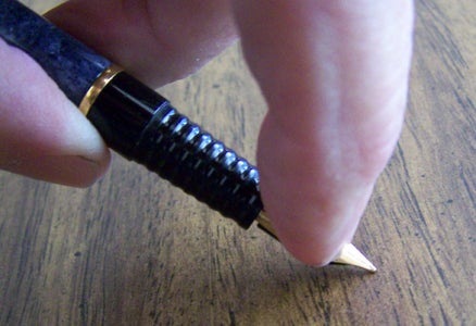

Step 3: Space Between the Tines
This Waterman pen let too little ink flow. One day I put my finger on the upper side of the nib and pressed down against a hard surface a bit. It was just enough to spread the slit between the nib tines a little and the ink flows as it should now.  Be careful when doing this, though, lest the space between the nib and the feeder increases too much.  See step 8.

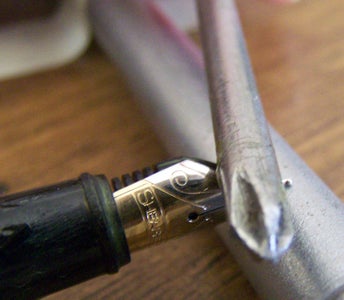

Step 5: Another Way to Spread the Tines
The tines on this Parker were a bit too close together. The nib is springy. The nib assembly unscrews from the section. The nib does not slide away from the feeder as on most pens, but is attached to it with tabs. A jeweler's screwdriver can be used to push the tabs away so a feeler gauge can be used to spread the tines a little. In this case I chose to use a feeler gauge rather than merely pressing on the front of the nib.  But, trying to spread the tines by twisting a feeler gauge in the slot can result in making a "V" at the tip between the halves of the iridium ball.  See step 2.

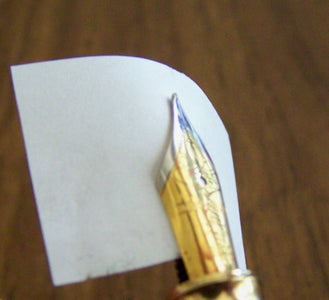

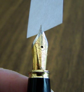

Step 7: Feeder to Nib Clearance
Fountain pens operate on the basis of a controlled leak. Key to this is the right amount of contact or clearance between the nib and the feeder. You should be able to pull a piece of copy paper between the nib and the feeder while feeling a fair amount of drag on the paper. When the nib and the feeder do not properly fit one another, several problems occur. Ink does not flow, or the pen leaks. The pen may be hard to start an ink flow.

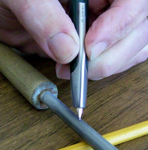

Step 10: For Left-Handed People and Others

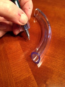

This is a Namiki Vanishing Point fountain pen. When the nib is extended for writing, the pocket clip comes between the user's thumb and first finger. Left-handed people tilt a pen a little, and that makes using a Namiki Vanishing Point pen difficult. In the days when fountain pens were very popular, it was not uncommon to have a point ground for a left-handed user. You can still get pens made for left-handers. Lamy makes one. I used a very fine knife sharpening rod to grind the point so it works much better for my left-handed writing. I held the pen as if the surface of the sharpening rod were a piece of paper and moved the pen as if I were writing. Check what you have done often with a magnifying glass. The disadvantage of grinding on the point is that the surface of the point is not as smooth, even though this improves somewhat with use.
See the second photo. Namiki produced a revision of this pen with a fatter barrel. It is easier to hold, but I do not have one. I went to the local hardware store and bought a short piece of 1/2 inch ID clear vinyl tubing. I cut about 1 1/4 inch from what I bought and slipped it onto the pen where I hold it. That seems to work quite well for me, although I may need to remove it if I want to use the pocket clip.

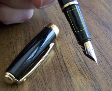

Step 11: Other Concerns for Left-Handers
I have a Schaeffer pen that came with two flats molded into the section. This may be ideal for a right-handed person, but it almost ruins the pen for a left-handed person. I painted over the flutes with clear fingernail polish and let it dry. I added several layers until the section was built up and I could shape it as if the flutes never were there. The pen is easy for me to use, now. (See the yellow rectangle for where the fluting was. You can still see a little irregularity on the surface of the polish.)
