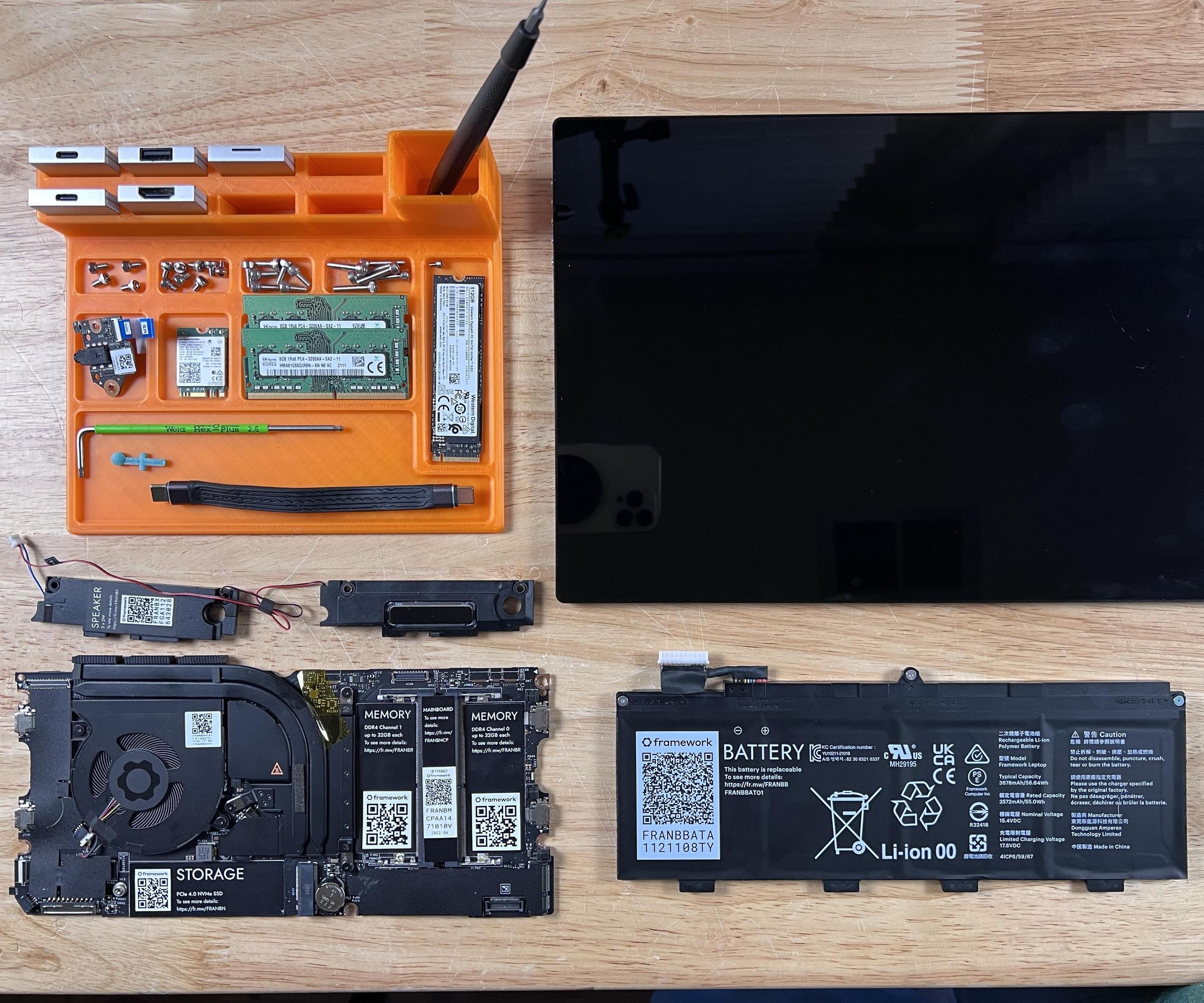

From the laptop itself you will need the following:
- Mainboard
- Expansion Cards
- Audio Board
- Wi-Fi Module
- Wi-Fi Antenna (Highly recommended that you buy a new one from Framework for the build, the antennas are very thin and break easily when attempting to remove from the display housing)
- Speakers
- Display
- Webcam and webcam ribbon cable
- Display Hinge (Specifically the left one with the L stamped onto it) I havent tried the new high weight hinges so I don't know if they work. I designed using the original hinges.
