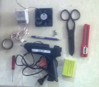

Step 1: Items Needed
1.Glue gun(with glue sticks)
2.Dust free exhaust fan (from old pc's mother board)
3.Pair of scissors
4.Craft clay
5.Screw driver
6.Cutter
7.Adopter(12volts or higher)
8.Permanent marker
9.Filer set (only half file needed)
10.Container (any size)
11.Pipe(for hose)
12.Screws

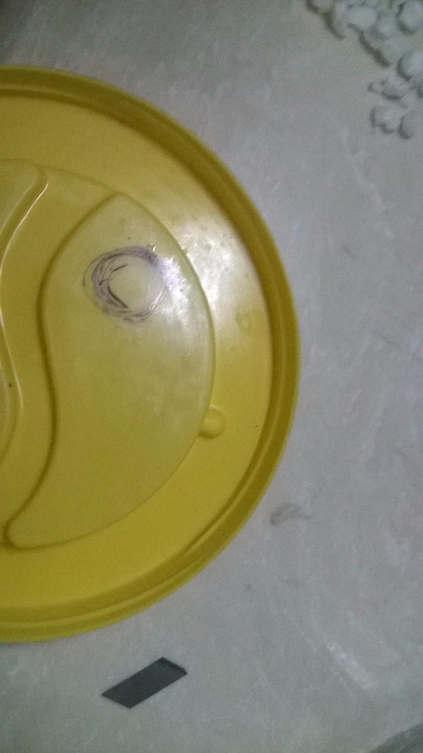

Step 2: Exhaust System
First trace the inner area with marker and the screw area and then cut that and screw up the fan with the logo outside.Place the paper towel in between so that trash does not goes out.
Step 3: Sealing
mix the craft clay and seal the area that was left open after the fan is secured in its place

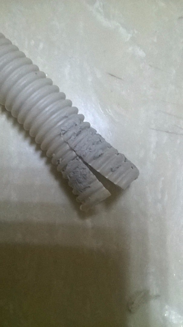

Step 4: Fixing the Hose
for fixing the hose first trace the diameter of the pipe and with help of a cutter cut out the circle. Now,devide and cut the 5cm area of pipe into 4 peices .fix the hose with a glue gun and close the container
Step 5: Finishing
now close the container and join the adapter with the exhaust fan with the +ve (red wire)inside adapter pin and other way round. we get a vacuum cleaner at no cost
