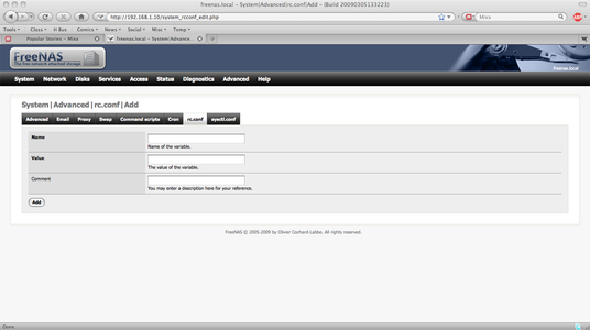

Start LPRng
Navigate to the FreeNAS web interface in a browser. Then go to System-->Advanced-->rc.conf
Use the "+" button to add two new entries:
Value: NO
Value: YES

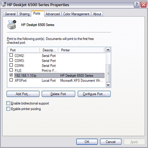

Step 10: Connecting a Windows PC
1) Go to Network Connections. Click the Advanced tab at the top, then "Optional Networking Components".
Enable both Management and Monitoring Tools and Other Network File and Print services. It will ask you to insert the Windows cd, which you should have around. This will allow us to connect via LPR
2) Go to the Control Panel and then to Printers. Run the Add a New Printer wizard.
3) Local Printer (do not automatically detect). Next.
4) Create New Port -> LPR Port. Next
5) Enter the IP address of the FreeNAS box. This is why we want it to be static. Enter the name of the print queue (if you copied my printcap, it's "lp" without quotes)
6) Install drivers and click through the rest of the wizard. Do not print test page.
7) Right click on the printer and open up properties.
8) Port Tab. Uncheck "bidirectional support"
9) Advanced Tab.
start printing after the last page is spooled. Check
Print directly& Uncheck
Hold mismatched& Uncheck
Print spooled& Check
Keep&.Uncheck
Enable advanced& Check
10) Now go back to the main tab and try printing a test page.

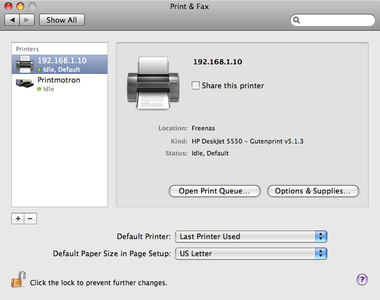

Step 11: Connecting With Mac OSX
1) Open up System Preferences -> Print and Fax
2) Click the "+" to add a printer
3) Go to the "IP" tab
Protocol: LPD
Address: The IP of FreeNAS
Queue: Name of print queue (if you copied my printcap, it's "lp" without quotes)
Name and Location are up to you
Print Using: Pick correct drivers*
*Some printers, like my HP Deskjet 6540 wouldn't let me use the usb drivers with the LPD. I had to instead pick one as close as possible (turned out to be 5550) and go with that. If the two models are similar, it should work without a problem.
