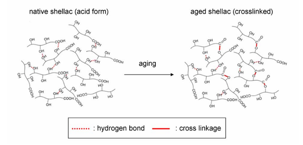

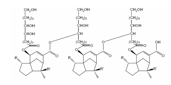

Shellac is a natural material derived from a resin secreted by the lac bug found in South Asia. It is a complex mixture of esters and polyesters of polyhydroxy acids whose composition is highly variable depending on the origin and type of refining. It is sold in flakes to be dissolved in a solvent. You can find flakes from blonde to garnet imparting tones from light golden to orange and amber.
Shellac is naturally waxy and can be purchased with or without the wax removed. Dewaxed varieties are said to have superior clarity and contain less than 1% wax compared to 3-5% in waxy flakes. Dewaxed shellac is also necessary if another finish is to be used over it. many other finishes will not bind to waxy shellac.
