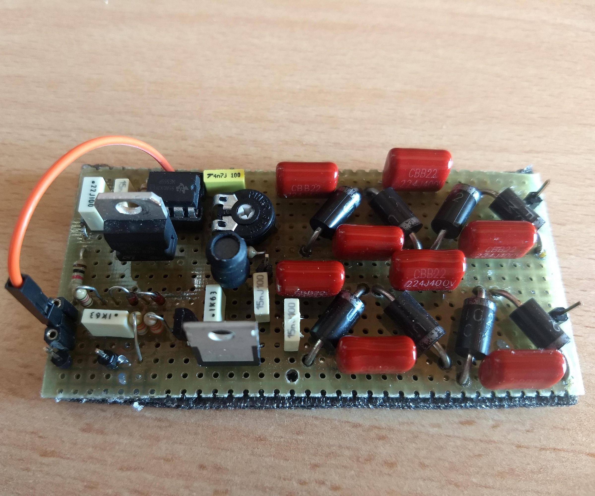

Step 4: The Peak Detector
The output of the amplifier (ie, the loudspeaker) is connected to the input of the peak detector (signal and ground). This circuit creates an output voltage (the green wire, connected to pin A0 in Arduino) which corresponds to the peak voltage of the sinusoid at the input. The yellow wire (connected to pin A1 in Arduino) is the signal that is fed into the peak detector, which is used by Arduino to check that the input signal is not clipped, in a small oscilloscope, at the start of the sketch.
The parts used are:
- An operational amplifier. It can be a LM324, LM358, or any other with single supply capability (ie, its common mode input must range to ground, and the output must reach down to ground level). I use the TLC272. There is no specific demand on slew rate, as the circuit does not place the opamp into slew rate limitations.
- 4 schottky diodes, like BAT54 or BAT85
- Capacitors: 100 nF, 1 uF
- Resistors: 2M, 390k, 220k, 100k, 100, 39 ohm
- A trimmer or potentiometer, 1k ohm
