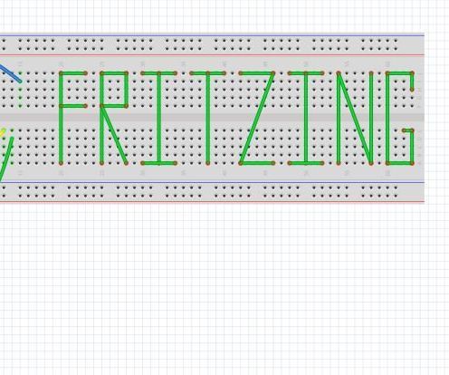

Step 1: Creating a New Circuit
When you start the Fritzing program you will prompted with a welcome screen. This screen contains news, your recent files, and some tips of the day. From here you can select the Breadboard window to start a new circuit. There will be a blank breadboard already in place. You can either build off of this board or you can delete it. This is the main work area. If you choose you can also build your circuit in the Schematic view or the Printable Circuit Board (PCB) view.

Step 3: Wiring Components
Once you have the components you will want to wire them together. By clicking on one lead of the component you can drag and start creating a wire. Drag the wire to the other pin you want to connect together and it will click to it.
If you are creating a large circuit with a lot of wires you can create bends in wires to change the path they take. Just by clicking on the segment of the wire you want to bend will create a bend point. You can manipulate this as much as you want. Another tip for working with a lot of wires is setting the wires to be curvy. If you go into the Edit drop down window and go to preferences. A window will open and if you click on the breadboard view you can have a curvy wire setting activated. This will allow you to bend wires in a unique fashion. You can also create bend points still by holding down Ctrl and clicking.
