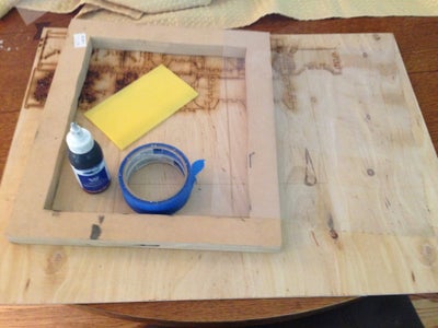

Tools Required
- Epilog Laser cutter/engraver. Other varieties may work fine too.
- Silkscreen printing station (optional -- I did it at home for what you see here)
- 9" Silkscreen squeegee (actually, I used a 6" $0.50 squeegee from Tap Plastics)
- Corel Photo-Paint. (Can just as easily be done with Photoshop, but instructions here are for Photo-Paint)
- Custom silkscreen frame. I just cut out a frame from 1" MDF using a table saw and scroll saw. (the 15 minutes does not include build time for the frame...)
- 2 mil Mylar sheet. I got this from Tap Plastics. They also have 5 mil mylar, but that didn't work. The 2 mil stuff comes on a roll and is about $1.50/foot (24" width). Get 5 or 10 feet and you can make a lot of screens :-)
- water based silkscreen paint
- tape

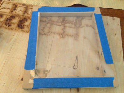

Step 4: Tape Your Screen to the Frame. Total Time = 11 Min
Tape your screen onto the frame. This takes about a minute.

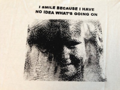

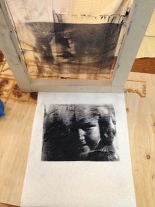

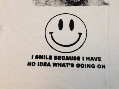

Step 5: Go Ahead and Do the Print. Total Time = 15 Minutes
And, here you go:

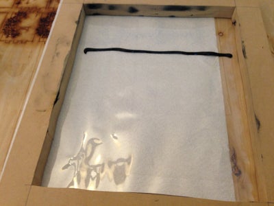

Basic steps for silkscreening are:
- float some ink over the screen before putting it on your t-shirt
- put the screen down onto your t-shirt
- slowly squeegee the ink into the t-shirt, making sure everyting his held steady
- lift the screen.
