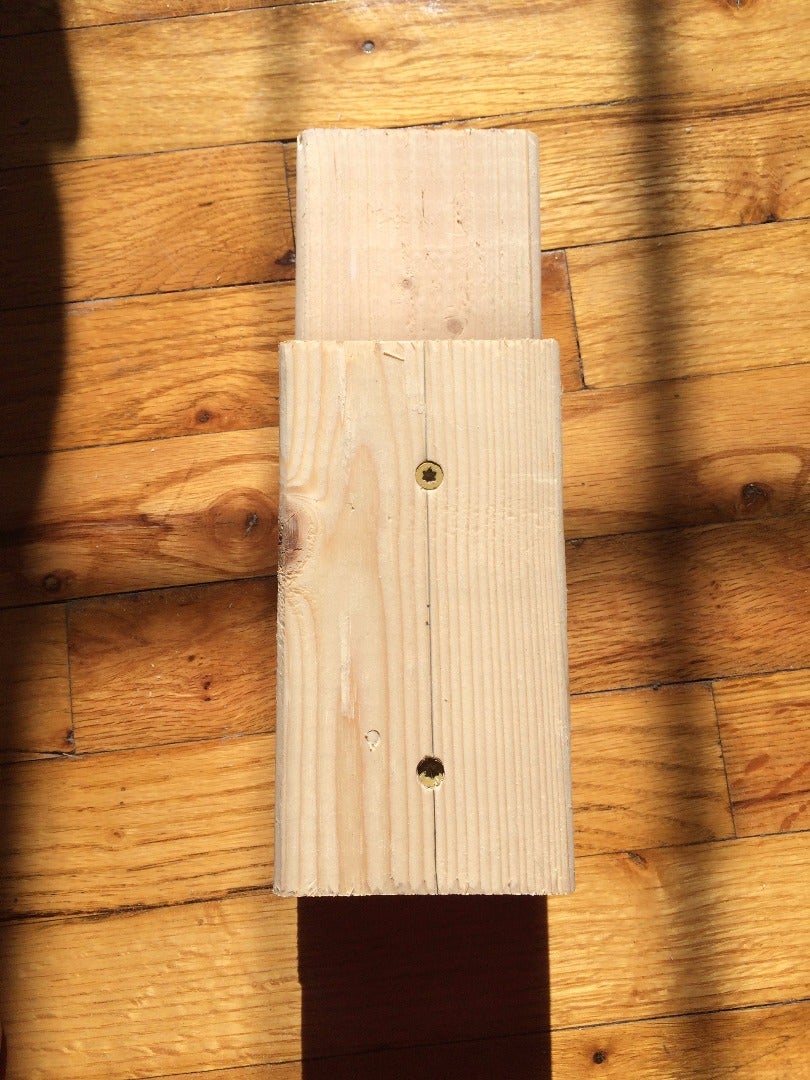

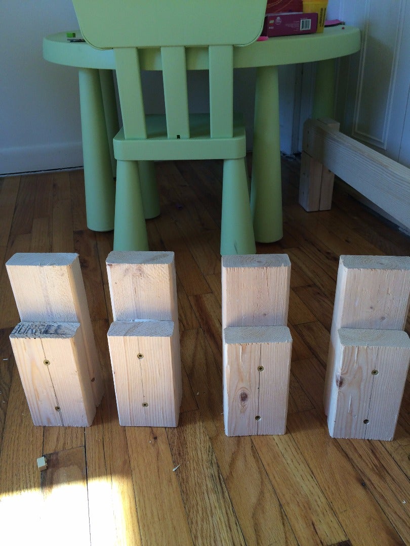

Use remaining 2x4 wood strips for legs. You would need 8 legs, build them by joining 10'' and 6.5'' 2x4 wood strips as shown in the picture. Glue the pieces and screw them with two 2.5'' screws.

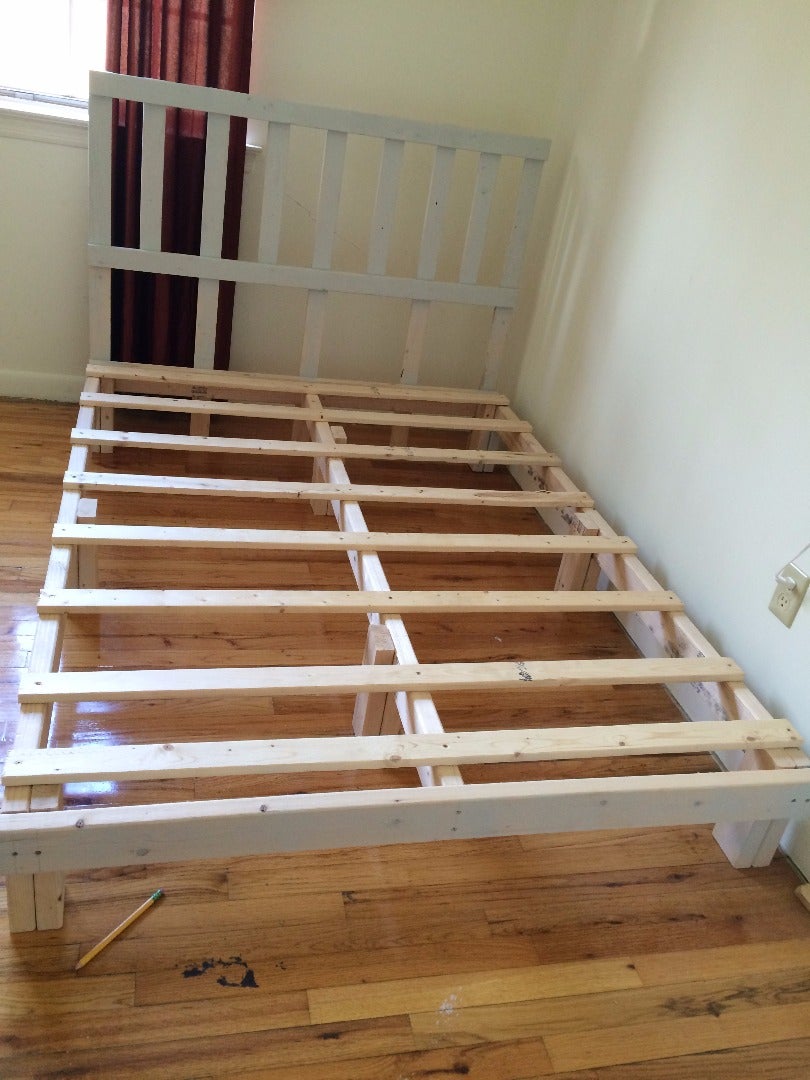

Glue and screw 54'' and 75'' 2x4s wood strips using 3'' deck screws. Do it from all the sides and then screw 1x3 strips in the gap of 7.5''.

Use remaining 1x3 strips for building headboard. Take five 40'' 1x3 strips and join them with two 53'' strips. Cut 20'' pieces from the remaining 1x3 and screw them in the gap (as shown the picture).
Here you go full size bed in about 6 hours costing around $80 :)
