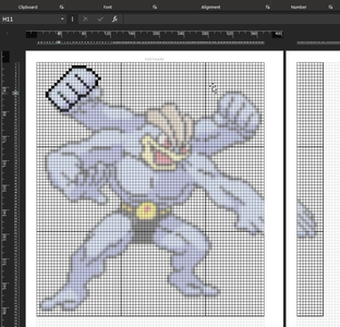

After trying a few sites, I eventually gave up and decided to try and draw my own design using Microsoft Excel.
Step 2: Excel Design

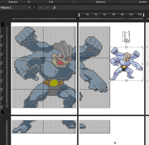

To start my design I inserted one of my images of Machamp that I'd found into excel. The peg boards I'd seen said they were 29 x 29 pegs square and used 5mm beads, which meant each board would be 14.5cm square.
On the worksheet in Excel I sized each row & column height and width to 5mm (for some reason you can only have 5.08 or 4.87mm there is no 5mm exact sizing option, so after typing 5mm Excel set them to 5.08mm). Also the sizing needs to be done whilst in page layout view, otherwise the worksheet is sized in pixels and the rows and columns have different pixel dimensions. 5 pixels high isn't the same as 5 pixels wide.
Once all the cells were sized I could then draw out a grid of squares 29 x 29 to match the size of each individual peg board. I then set the paper size to A2 to reduce the amount of sheets I need to print out later on. The bigger your design obviously try and print on as bigger paper as you can, saves time later trying to line individual sheets of paper up.
As I initially wanted my design to be around 500mm tall I positioned 9 peg boards on my excel sheet which gave me a height of around 435mm and filled a sheet of A2 which was plenty big enough.
From here there were now two ways of creating my design, I could either copy along with the image I'd inserted to the worksheet, which is what I did, first drawing the outline of Machamp using filled in squares, trying to copy the design from the image on the page next to me as best I could.
The other way and probably slightly easier, if you can size your inserted image correctly, is to increase the opacity of the image so that the gridlines of the worksheet begin to show through. You can then fill in the squares over the top of the image to give you your design, kind of like how tracing paper works.
My design ended up around 3647 beads in total, which was good enough to include all the detail I wanted, whilst not being too big that'd take ages to complete. Once I finished copying the outline in black I could then start to fill in the rest of the squares with the colours of Machamp to bring the design to life.
At this point I'd not ordered any materials as I had no idea how much of anything I'd need, but now I had a design in Excel I knew how many peg boards I needed by which squares Machamp covered. To calculate how many beads I'd need I used Excels ability to write formulas.
After I'd coloured in each square a different colour, I then assigned that square a corresponding colour code, 'k' for black 'db' for dark blue, 'b' for blue, so on and so on. I'd managed to only use 10 colours, but I still needed to buy these 10 colours and as they come in bags of 1000+ I didn't want to overorder on colours I didn't need many of.
To get the exact amounts of each colour I used a count formula, using my colour codes as the criteria to give a total for each individual colour. For those interested the formula was as follows:
=COUNTIF($A$1:$CI$87,"k")
$A$1:$CI$87 is the area my design occupies on the worksheet i.e. it starts on cell A1 and covers all cells up to cell CI87. The "k" means look for that colour code and only count cells with that code in. For the other colours all I had to do was replace the "k" with the other letters for the other colours, "db", "b" etc.
My first formula above, returned a value of 1002 which meant I'd need 1002 black beads for my outline of Machamp, this and the two blue colours were the highest totals all over a 1000 beads each.
I've attached my Machamp layout drawing so you can see it in more detail, sadly Excel files aren't supported, so its in pdf format.
