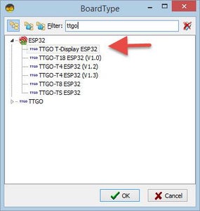

Start Visuino as shown in the first picture Click on the "Tools" button on the Arduino component (Picture 1) in Visuino When the dialog appears, select "TTGO T-Display ESP32" as shown on Picture 2

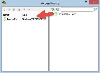

  • Select TTGO T-Display ESP32 board and in the properties window expand "Modules>WiFi>Connect To Access Points
  • Click on the Connect To Access Points 3 Dots
  • In the AccessPoints window drag "WiFi Access Point" to the left side
  • In the properties window set SSID (name of your WiFi hotspot or router)
  • In the properties window set Password (password of your WiFi hotspot or router)
  • Close AccessPoints window

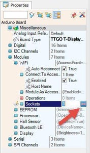

  • Select TTGO T-Display ESP32 board and in the properties window expand "Modules>WiFi>Sockets
  • Click on the Sockets 3 Dots

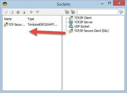

  • In the "Sockets window" drag TCP/IP Secure Client (SSL) to the left
  • In the properties window set Host to: www.bitstamp.net
  • select "CACert" and click on the 3 dots button and in the "CACert window" paste the Certificate that you got in the previous step
  • Close the "Sockets window"

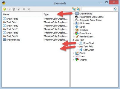

Select TTGO T-Display ESP32 board and in the properties window expand "Modules>Display>Elements" Click on the Elements 3 Dots
  • In the Elements window Drag "Draw Text" to the left and in the properties window set size to 2 and text to ASK.
  • In the Elements window Drag "Text Field" to the left and in the properties window set size to 3, color to "aclGold" and Y to 20.
  • In the Elements window Drag another "Draw Text" to the left and in the properties window set size to 2 ,text to BID and Y to 48.

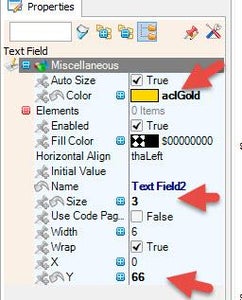

  • In the Elements window Drag another "Text Field" to the left and in the properties window set size to 3, color to "aclGold" and Y to 66.
  • In the Elements window Drag another "Draw Text" to the left and in the properties window set size to 2 ,text to LAST and Y to 92.

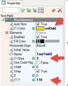

  • In the Elements window Drag another "Text Field" to the left and in the properties window set size to 3, color to "aclGold" and Y to 110.

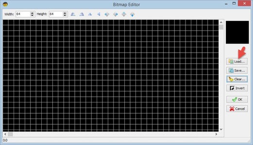

  • Optionally you can add bitmap to the Display, to do that in the Elements window drag "Draw Bitmap" to the left side and in the properties window set X to 160, Y to 30
  • Click on the Bitmap 3 Dots
  • In the Bitmap Editor Load the Bitcoin bitmap (picture 1) and close the Bitmap editor
  • You can find other bitmaps at https://iconarchive.com/search?q=bitcoin

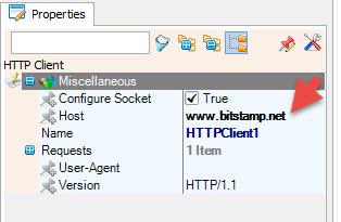

  • Add "HTTP Client" component
  • Select "HTTPClient1" and in the properties window set Host to www.bitstamp.net

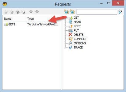

  • Click on the Requests 3 Dots

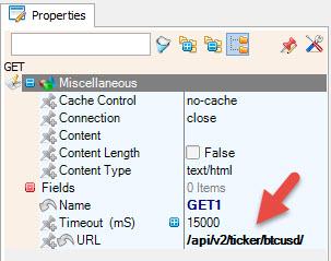

  • In the "Requests window" drag "GET" to the left side
  • In the properties window set URL to: /api/v2/ticker/btcusd/
  • Close the requests window

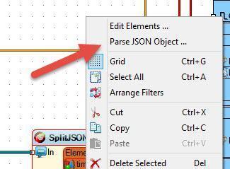

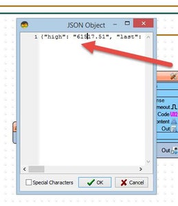

  • With the mouse right click on the "SplitJSON1" and in the menu click on the "Parse JSON Object.."
In the "JSON Object" window paste this sample code(avalible on https://www.bitstamp.net/api/v2/ticker/btcusd/ )
Or copy paste the following:
{"high": "61517.51", "last": "59946.59", "timestamp": "1635092369", "bid": "59913.89", "vwap": "60635.81", "volume": "1111.78956785", "low": "59510.00", "ask": "59930.59", "open": "61306.64"}
  • Close the "JSON Object" window

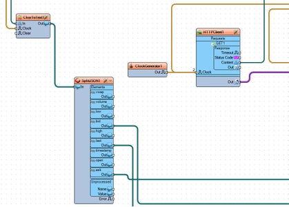

  • "SplitJSON1" component will now create new pins
Step 8: In Visuino Connecting Components
  • Connect "ClockGenerator1" pin Out to "HTTPClient1" pin Clock
  • Connect "TTGO T-Display ESP32" pin [Connected] to "Delay1" pin Start
  • Connect "TTGO T-Display ESP32" pin [Remote Connected] to "HTTPClient1" pin Clock
  • Connect "HTTPClient1" pin Content to "CharToText1" pin In
  • Connect "HTTPClient1" pin to TTGO T-Display ESP32 > WiFi>TCP Secure Client1 pin In
  • Connect "Delay1" pin Out to "CharToText1" pin Clock and TTGO T-Display ESP32 > WiFi>TCP Secure Client1 pin Disconnect
  • Connect "CharToText1" pin Out to "SplitJSON1" pin In
  • Connect "SplitJSON1" pin [Ask] to TTGO T-Display ESP32 >Display Text Field1 pin[In]
  • Connect "SplitJSON1" pin [Bid] to TTGO T-Display ESP32 >Display Text Field2 pin[In]
  • Connect "SplitJSON1" pin [Last] to TTGO T-Display ESP32 >Display Text Field3 pin[In]

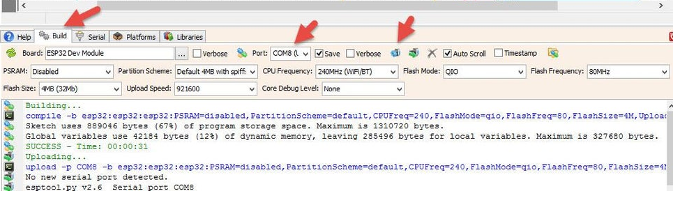

Step 9: Generate, Compile, and Upload the Code
In Visuino, at the bottom click on the "Build" Tab, make sure the correct port is selected, then click on the "Compile/Build and Upload" button.
