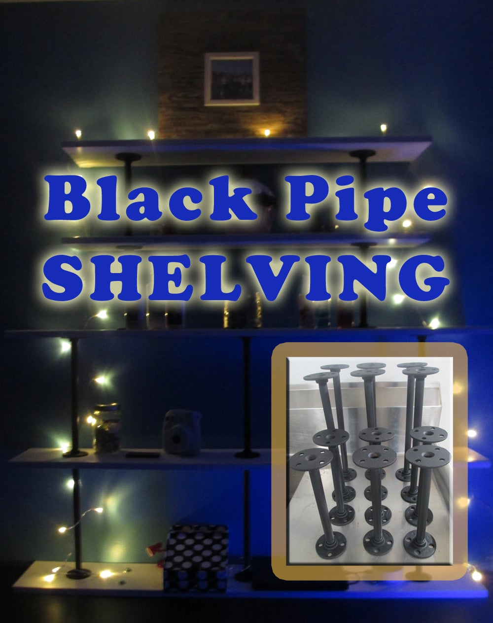

I will show how I made a Glowing 5 Tier Desktop Shelving Unit.

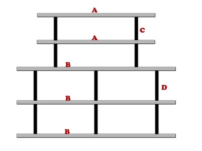

Step 1: The Plan and Materials
The plan is fairly simple. Since you will probably have a need for custom dimensions, I will simply list parts and dimensions below rather than including in the diagram.
MDF Boards:
  • (B) Qty (3) 48" x 7 1/4" x 5/8"
  • (A) Qty (2) 36" x 7 1/4" x 5/8"
  • (not pictured) Qty (2) 24" x 7 1/4" x 5/8" (these were used to make a smaller unit)
Black Pipe:
  • (D) Qty (6) 3/8" x 12" NPT Threaded Black Pipe Nipple
  • (C) Qty (6) 3/8" x 8" NPT Threaded Black Pipe Nipple (2 were used for smaller unit)
  • (not pictured) Qth (24) 3/8" FNPT Black Malleable Iron Floor Flange (4 were used for smaller unit)

After cutting all boards to length, mark where all the flanges will be fastened to each board.
Per my designs and plans...
For the 48" boards, flanges were placed at 6, 24 and 42 inches. In other words, at center and 6 inches in from each end. I placed a center support for these boards to help prevent sagging and warping.
For the 36" boards flanges were placed at 6 and 30 inches. No center support.

Step 13: DONE!
Well here it is folks! Within an hour my "Tweener" had stuff pulled out of drawers and up on the shelves. It will be interesting to see how her organization evolves over the years.
MAKE IT GLOW!
I did add a little bling with some mini-LED lights. Just a little glow to the project with a remote control set of lights I found on Amazon.
