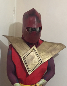

  1. Now your foam Green Ranger shield is covered in gold paint completely, you need to add the black details to the ensignia and all the Green Rangers details from your reference picture, by using your black posca marker or black Acrylic paint can be good and use your gold sharpie marker pen, for more added gold details to your shield if you like.
  2. Now you'll need your 12 x 18 cm yellow foam, cut them 3.5" 9cm width for the shield strap position and added velcro to where they'll be place, sometimes the velcro will have a sticky end to them which can be annoying once trying to stick them on, but be cautious and stick once on each end of the yellow straps and and under your dragon shield, and place them as if you were wear a vest or a rucksack strap under your armpit next to your ribcage, (DETAIL:- You don't really need the under strap part, as you can see on the photos in full cosplay below,the model is with and without the straps, but it can be of use, if wanting to be in position of the shield onto your chosen costume).
  3. And now you are done, try it on for yourself and KE-YAHH... your ready to save the world, in the Power Rangers or Super Zentai way!!!
