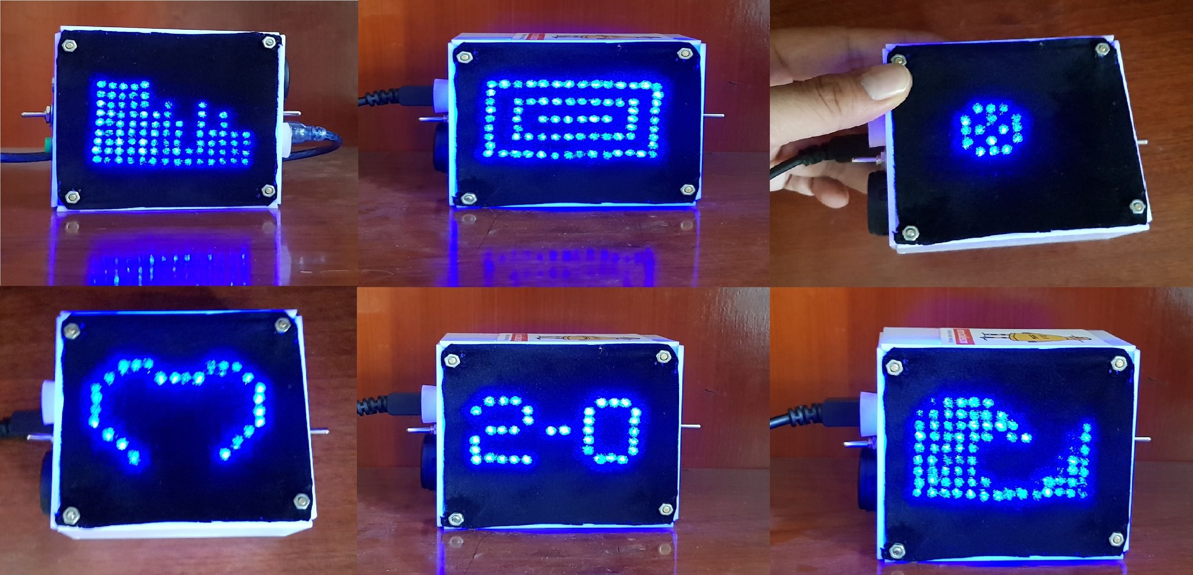

This gaming box is made from Arduino Uno R3, LoLShield, MPU6050 and Microphone module.
- With LoLShield, we can show a message/scrolling message or animation picture like: plasma effect, sinewave effect...
- With MPU6050, we can read value from accelerometer and gyroscope to control movement for simple games like: Pong, Tetris, Invader...And we also make a scrolling message with scrolling speed base on accelerometer.
- With microphone module & 3.5mm audio jack, we can use this game box as spectrum analyzer or sound meter.

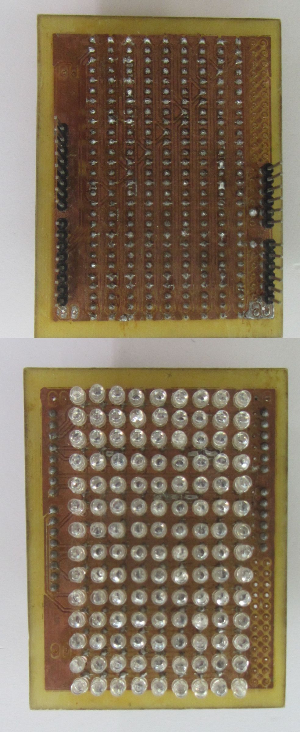

For LoLShiled, I did it by myself. It is not easy for etching a double sided copper clad pcb board. You can refer to PCB design at: https://github.com/jprodgers/LoLshield & make one for yourself.
You can see LoLShield's video for first testing & spectrum analyzer testing:

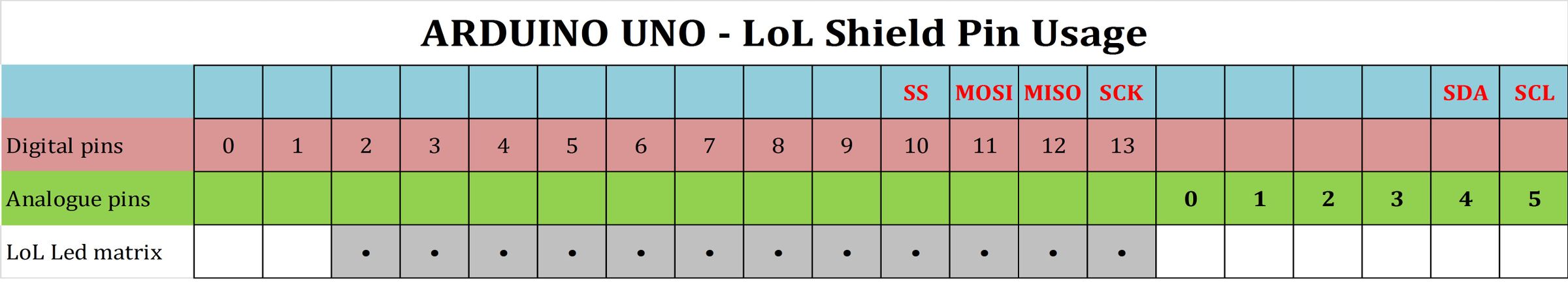

The LoL Shield leaves analog pins A0 to A5 free for inputs. For detail, let see picture below for LoLShield pin usage:
From schematic, we can see:
- A0: connect to 2 position toggle switch to select analog input from audio jack or microphone module.
- A1: connect to push button.
- A2 & A3: connect to 3 position toggle switch for selecting games/ animations mode.
- A4 & A5: connect to SDA & SCL pins of MPU6050. (Or we can use DS3231 - Real Time Clock - as optional).

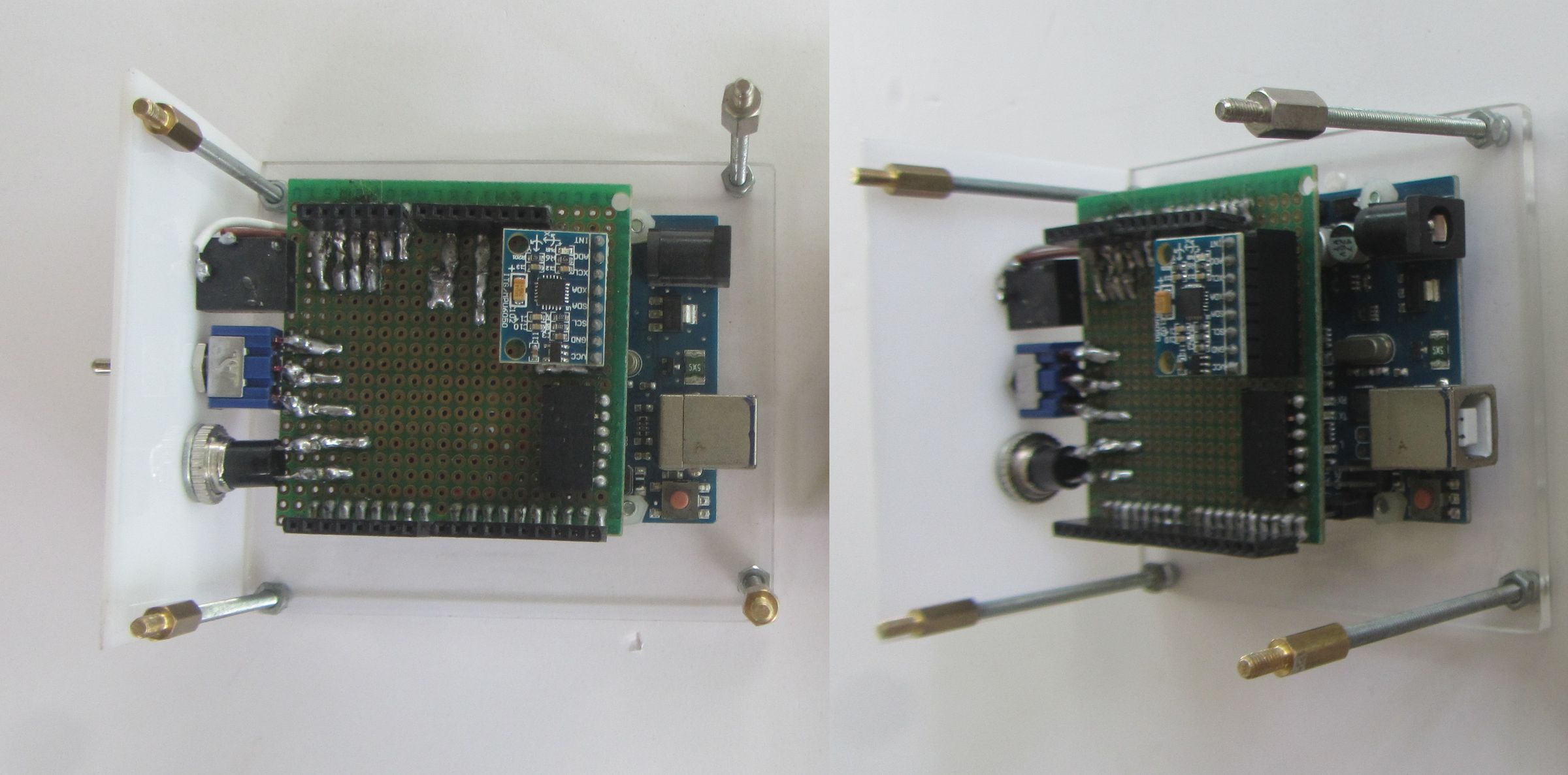

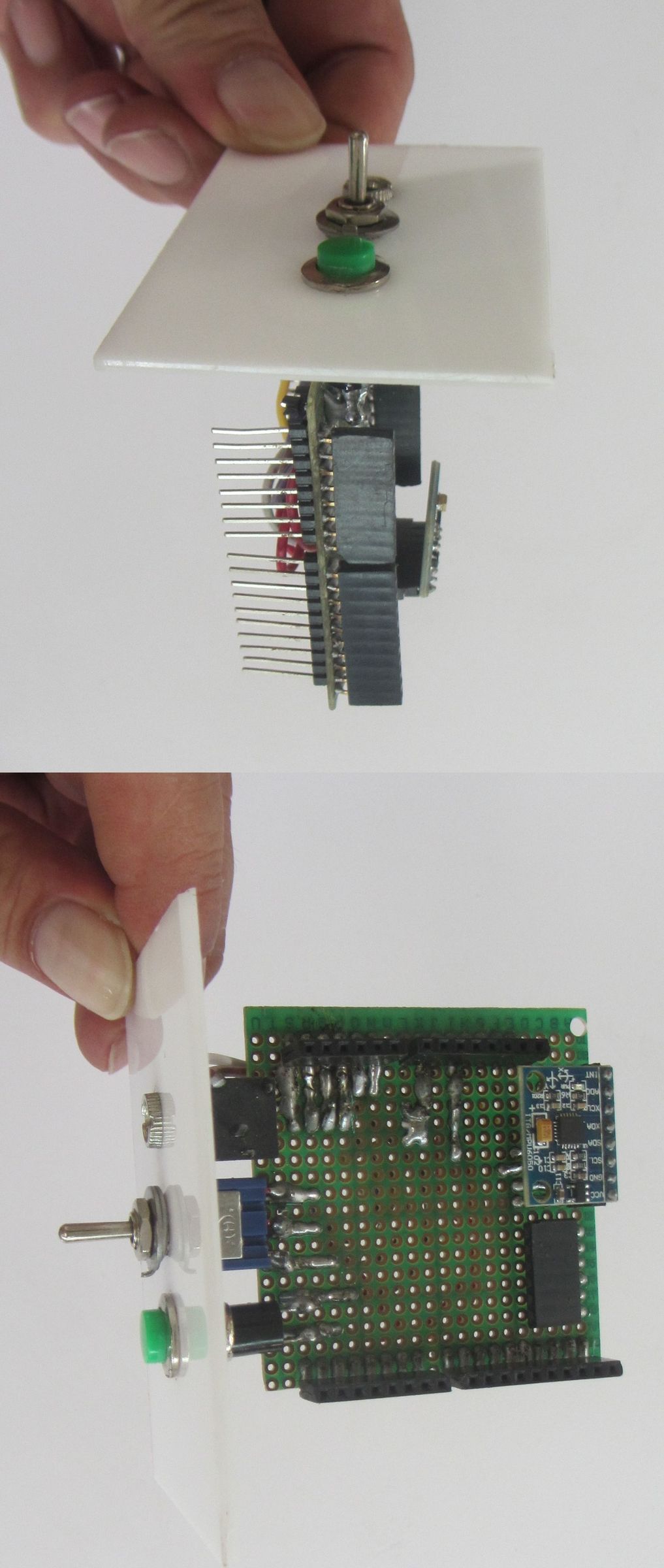

Step 3: ADAPTER SHIELD

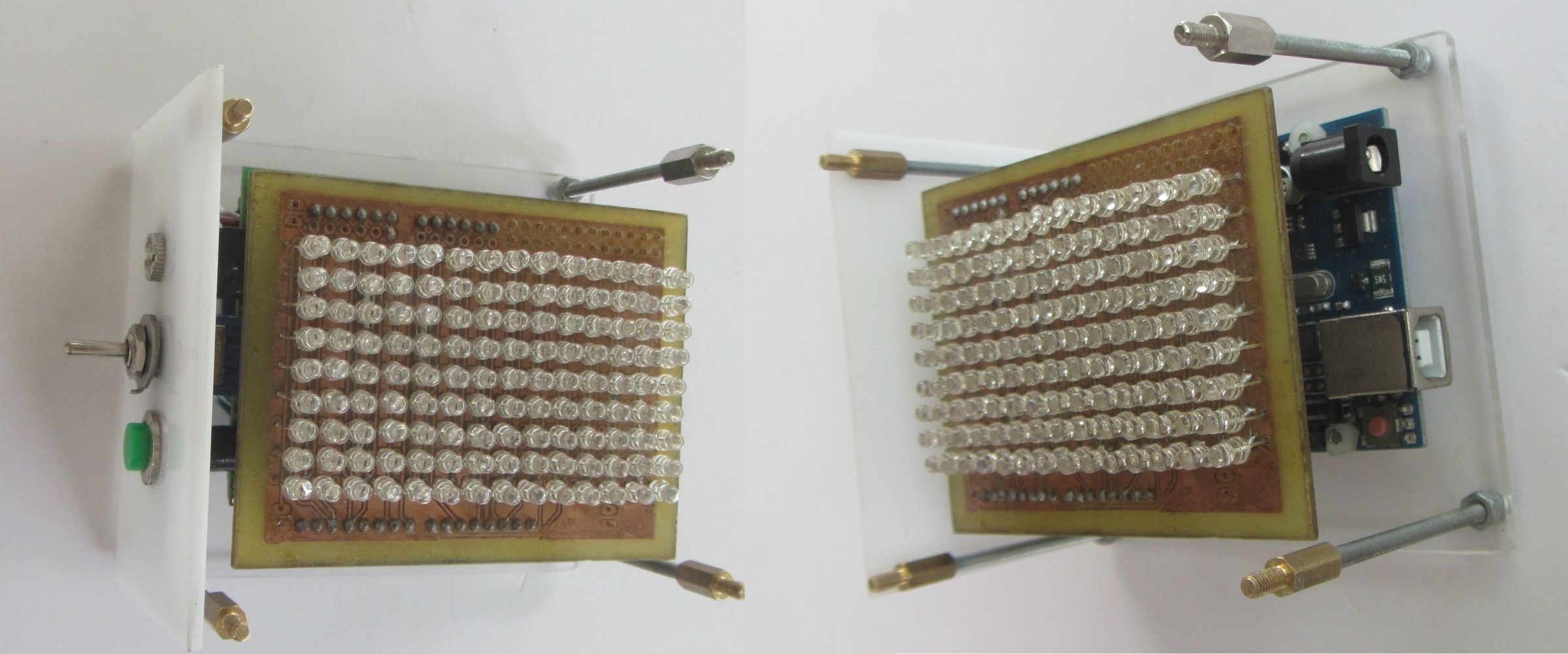

This adapter board is used for connecting between Arduino Uno and LoLShield. On the adapter board, we solder all components: button, switches, MPU6050, Microphone module KY-038, audio jack 3.5mm, resistors. At bottom side, we solder 2 row male headers connecting to Arduino & top side, we use 2 row female headers connecting to LoLShield.
- For 1st version, I didn't use Microphone module so analog input pin was directly connected to audio jack. You can see some project pictures:
- For 2nd version, I added Microphone module and 2 position toggle switch. So analog input A0 can be selected through toggle switch between audio jack or microphone module.

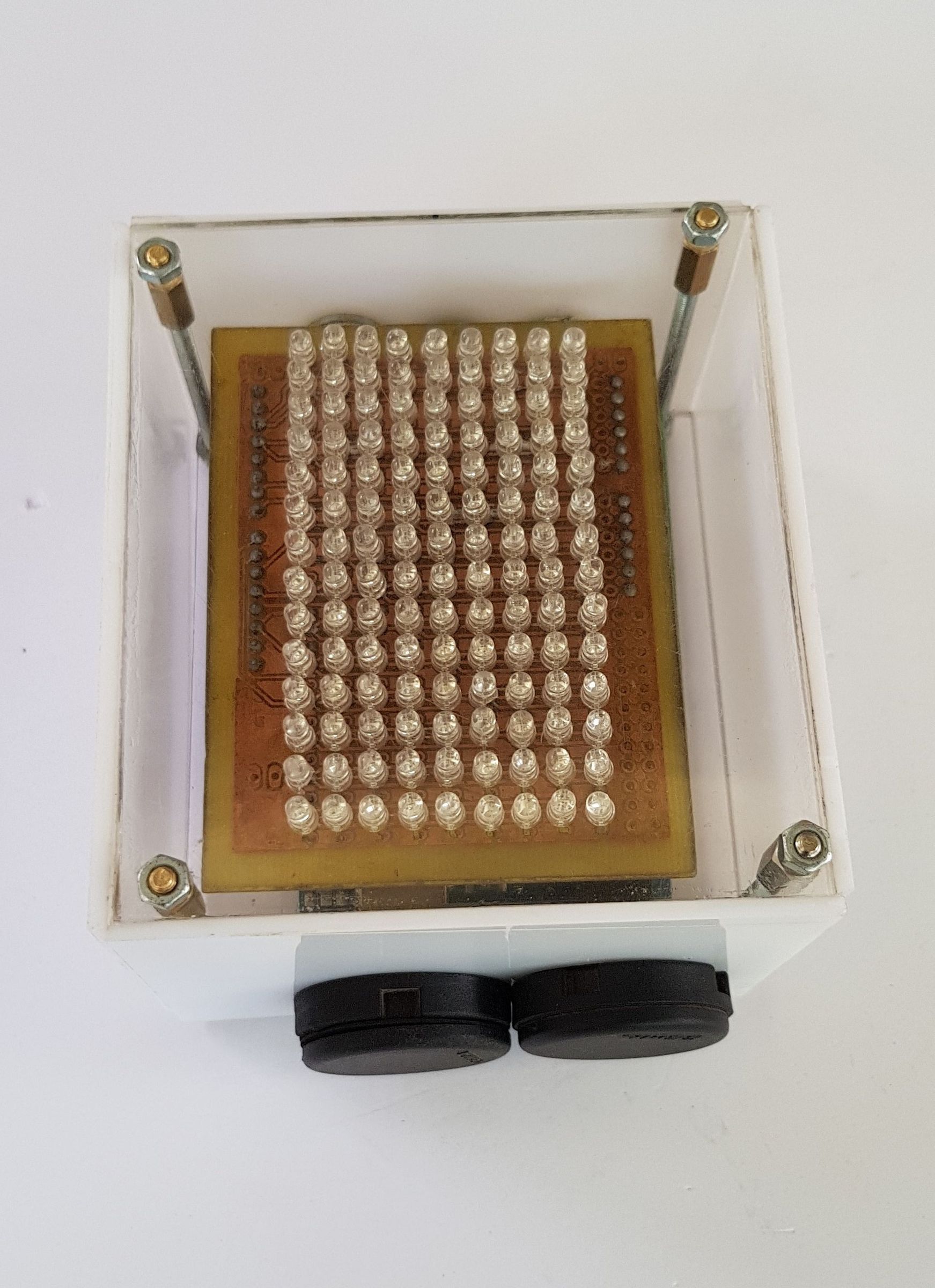

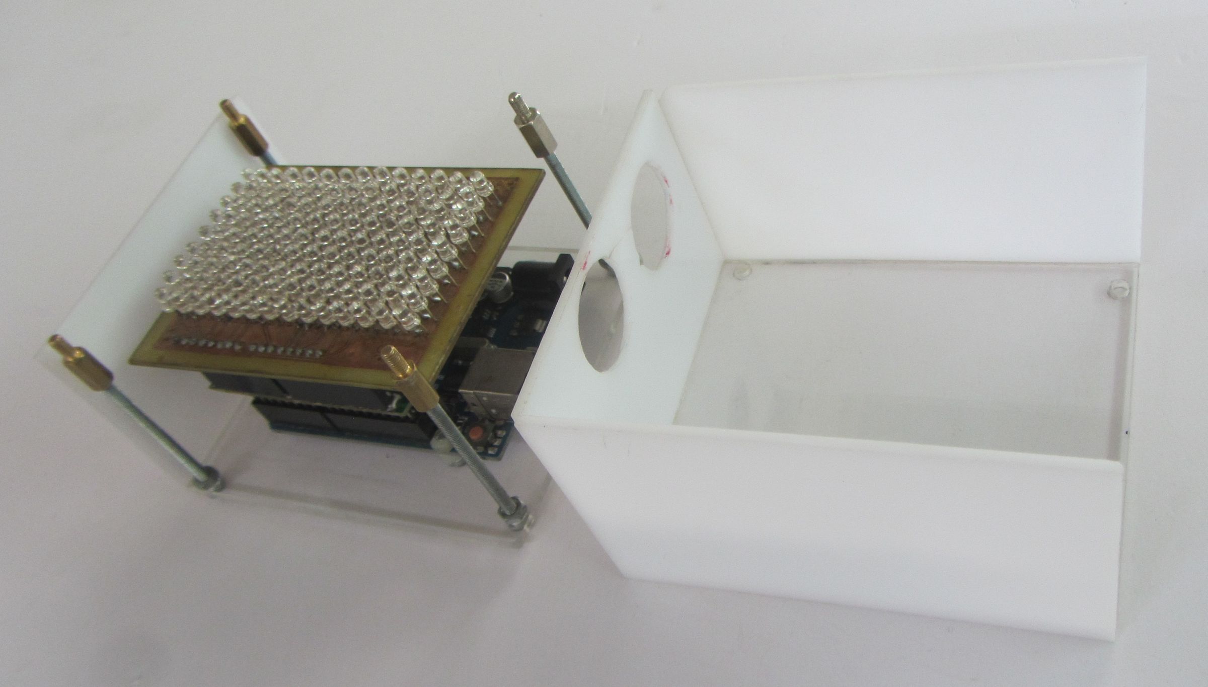

Step 4: GAME BOX
Steps below show how to build a game box (1st version).
- Game box components

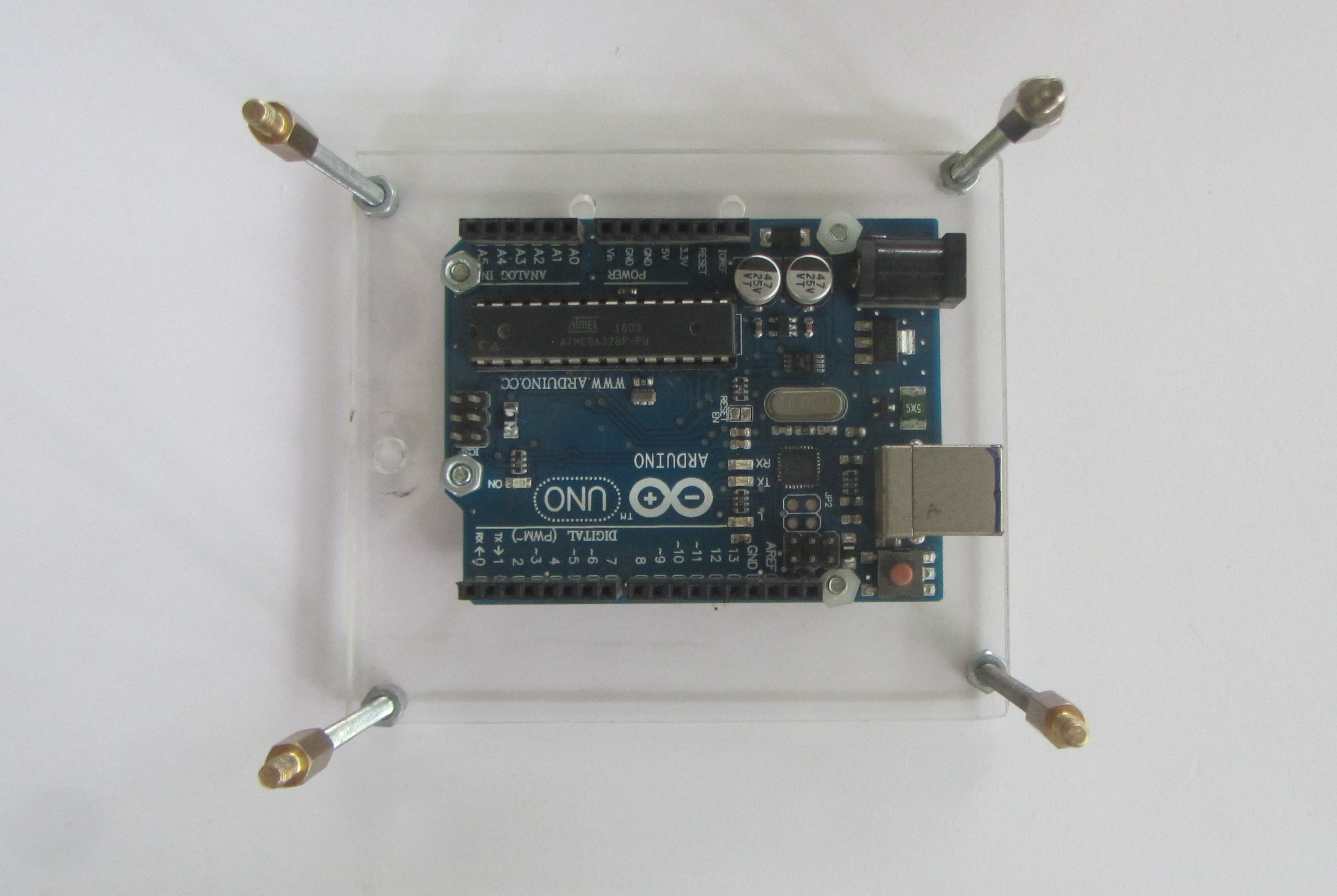

- Make Arduino base:
- Connect Adapter board to Arduino Uno:
- Connect LoLShield to Adapter board:

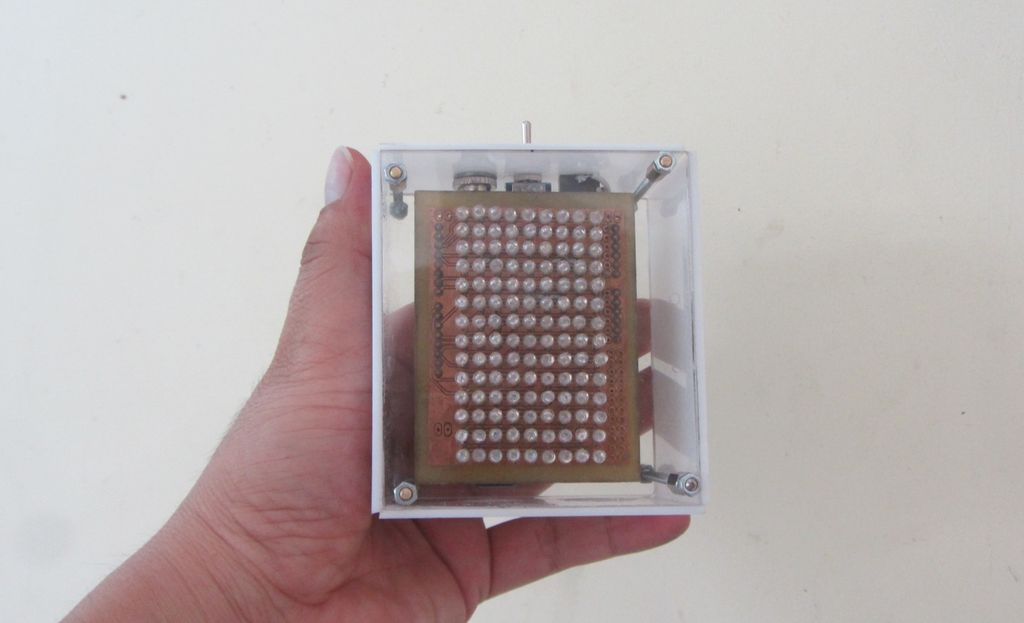

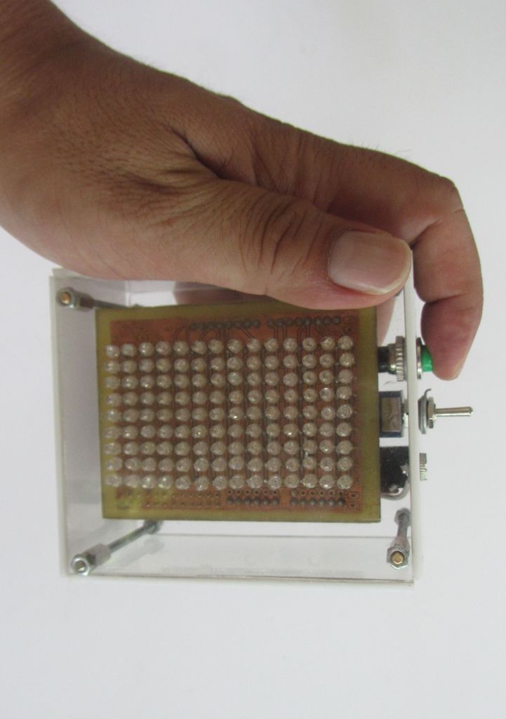

- Cover the game box:
- Finish:

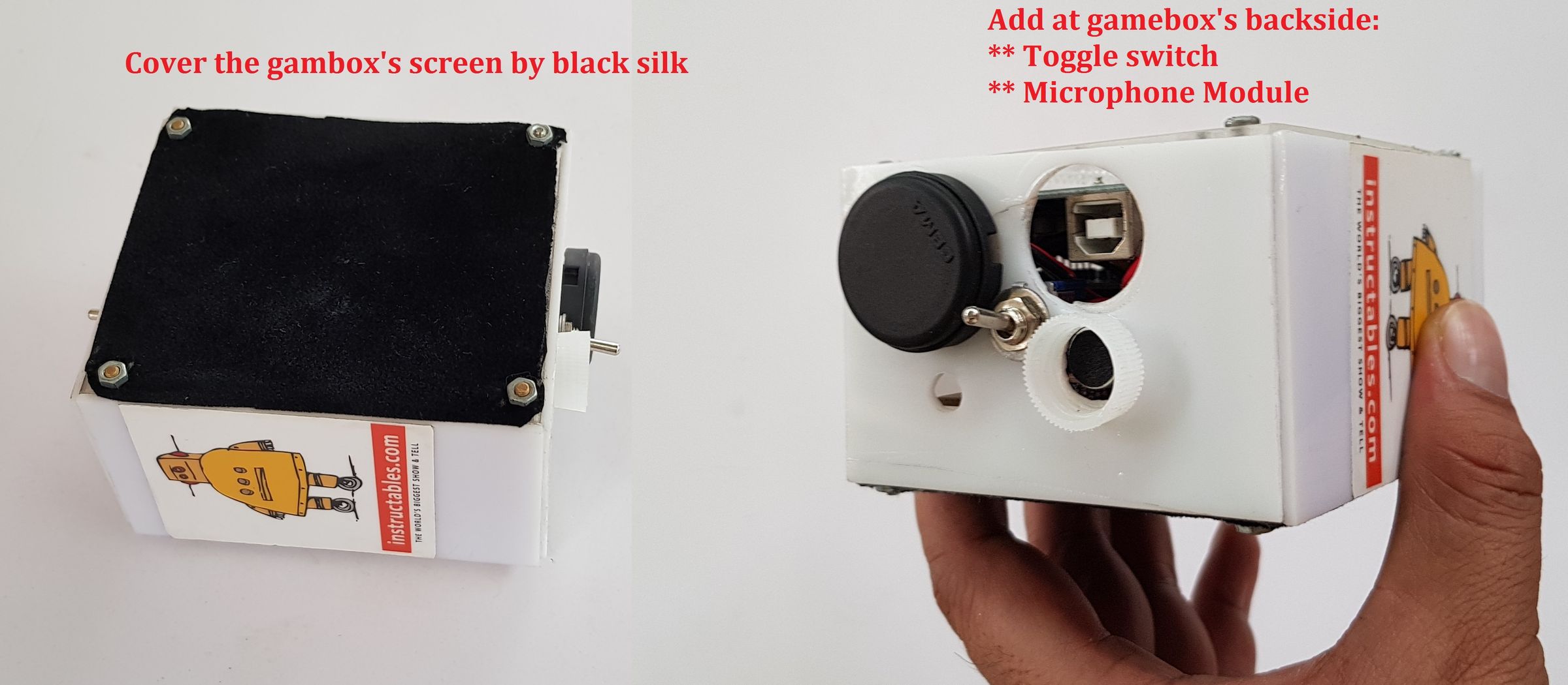

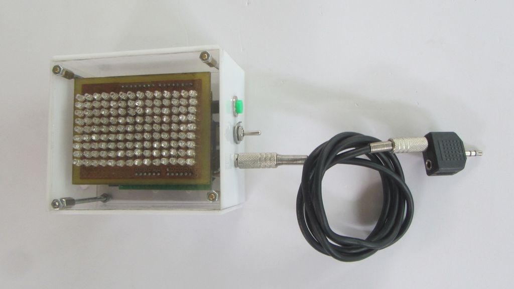

Step 5: GAME BOX - UPDATE
I covered the black silk on the led screen to reduce the glare (glared filter) when it was recorded by a camera. And I also added Microphone module and 2 position toggle switch at backside as explained before. So analog input A0 can be selected through toggle switch between audio jack or microphone module.

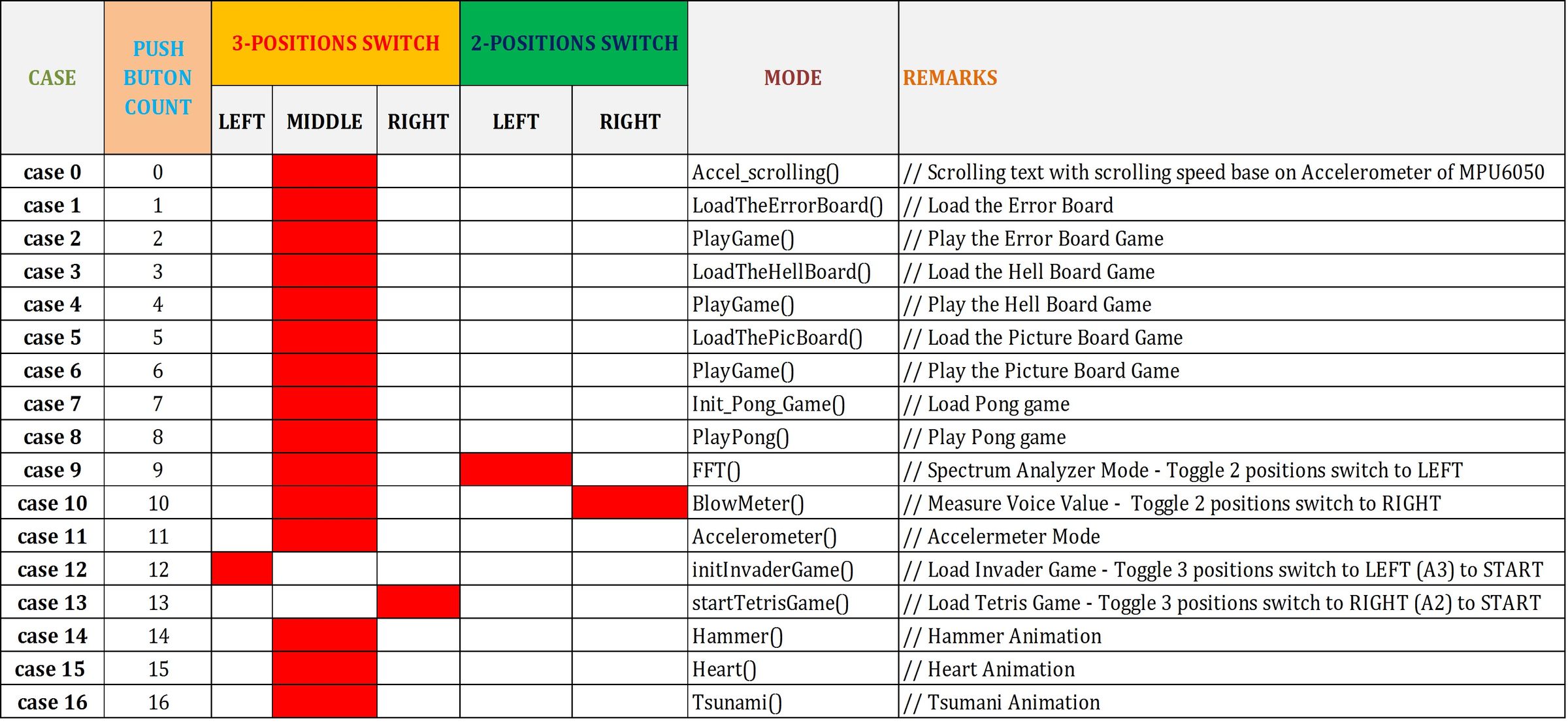

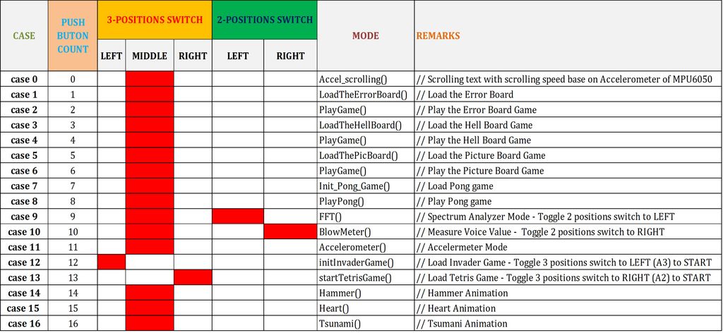

Base on the program, I count number of pressing at push button to change games mode and animations mode. But for Tetris and Invader game, I have to start these games by using 3 postions toggle switch & use push button to fire on Invader/ rotate blocks on Tetris. We can also use Microphone Module to fire (Invader) / rotate blocks (Tetris) but it looks very weird & funny.
All animations & games mode are summarized in table below:
We can add more games or animations to program but take note value at: "buttonPushCounter % 17".
