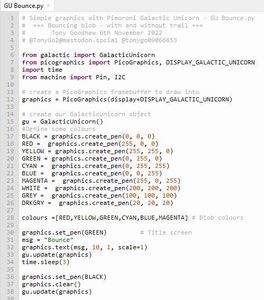

There are plenty of comments in the code to help your understanding.
Here we set up the board, create some colours and display the title on the screen for 3 seconds before clearing the screen.
