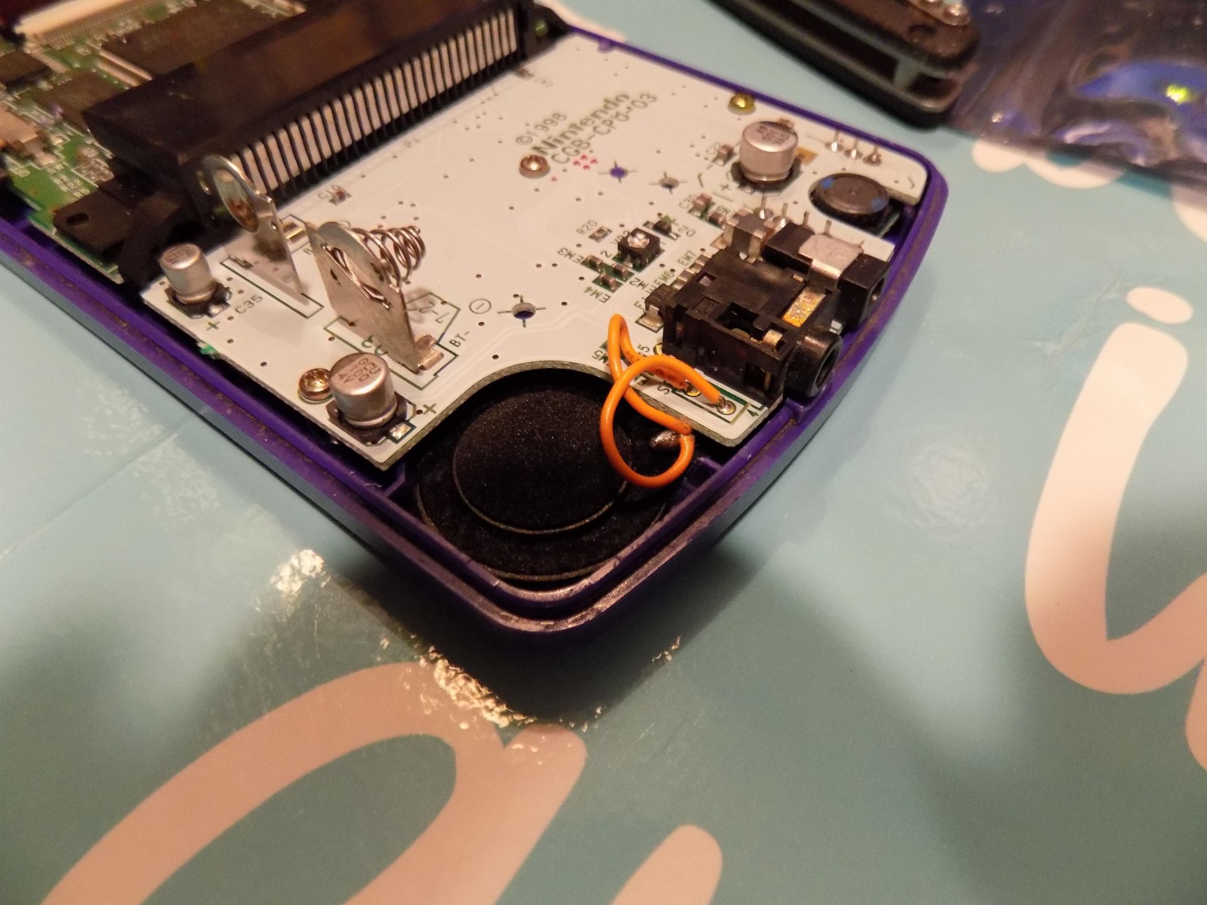

Step 3: Upgrading the Speaker
The old speaker is attached with 2 wires.
Remove the speaker with a soldering iron- you can easily see that the old speaker is quite corroded.
The new speaker has 2 little contacts/soldering points.
Solder the wires onto the new speaker- it does not matter which wire goes to which contact/solder point.
On this speaker, only a drop of solder is needed to put hold the wires in place.
Note that this speaker does NOT fit into the original hole.
Trim the speaker port (marked in the picture in RED) with a utility knife and just snap out. It is thin plastic and easily manipulated.
Now close everything back up, you are done! Remember to test before you put all the screws in.
