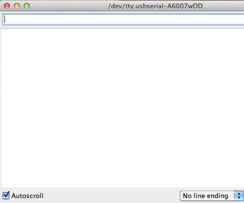

Step 4: OUTPUT
OUTPUT
In the presence of LPG (BUTANE) it will glow red and buzzer will turn on
In the absence of LPG (BUTANE) it will glow green
