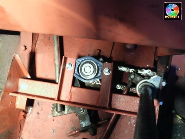

1 year ago on Step 8
How did you move the steering system over to the right? Thank you
Reply 1 year ago
I did this so long ago it is hard to remember....A couple of chain wheels and support brackets linked by chain, hopefully the photo's may help

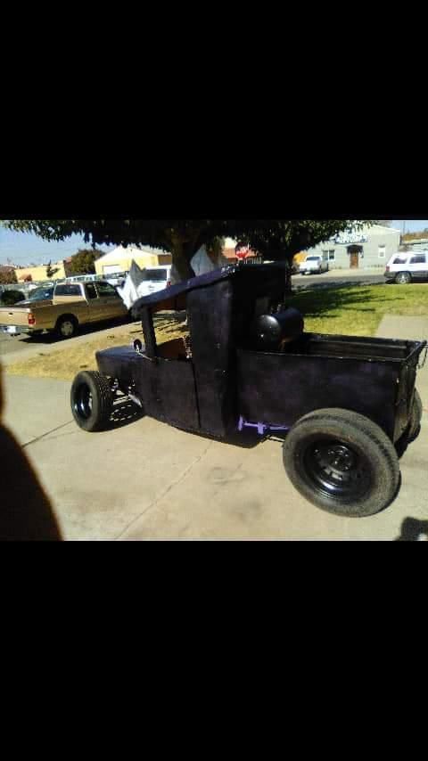

I love ur mini jeep I'm building one rn but I'm extending the rear end suspension as well as replacing the front end with a arms and suspension make it look like scrambler cj8 Ian field miniature Model A pickup rat rod out of a 250 Quadrunner I have also build a miniature T Bucket with a miniature teardrop camper love to touch base with you on some of your ideas you could also look me up on FB Shane's Bearded Customs
Reply 2 years ago
Some very cool builds there, I am working on my next one too, this time a Scammell pioneer, a bit more complex than the Jeep!
