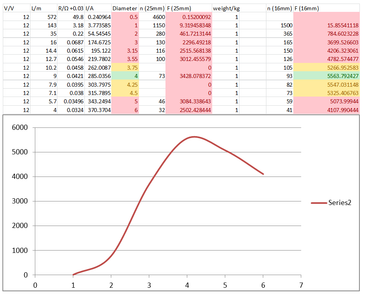

F=(a(4π*10^-7)/((nI)^2)/(2g)^2)
Where F is force produced, a is cross sectional area of coil, n is number of turns, I is current and g is gap between core and coil. With my original design, this equation told me that a 0.5kg projectile would leave the barrel at around Mach 25, which may have been a slight overestimation. Using a much more reasonable estimation of current at 250A I calculated the force to be around 80kN which is still quite absurd. I had to accept the fact that this equation was ever so slightly optimistic, but it did give me a very good idea of what values I should alter to get the most force out of my Coilgun. Its easy to see what values need to be increased or decreased, so although it was a bit off in its estimations it allowed me to easily see how I would make a more efficient Coilgun. With this in mind I made it the priority to have the number of turns and current as high as possible, and the gap as small as possible. Its also important to consider that you can get more turns with thinner wire (a) but current must be less so as not to melt the wires. Also, more turns means higher resistance, which reduces current. Therefore I opted for very thick cable for the coil, with a comparatively small number of turns and quite high current. An alternate option would be to go for as many turns as possible with as thick wire as possible and not worry about current, but that could be very expensive.
Later in the instructable I used the equation with several different wire thicknesses and two different barrel diameters to find the best wire for my needs.

I made the barrel first so that I could plan the rest of the circuitry around what resistance the barrel ended up being. The actual construction was quite simple, but if you're making this for yourself I would implore you to find a different way to construct this section because I was under time constraints and there are a lot of improvements I'd like to make. However, the science of making it as efficient as possible was fun and interesting to research.
I've written a great deal about this in my final report which you can download in the introduction, but the basics are as follows. A thicker wire will always be more efficient (because it has less resistance) until either there is too greater gap between adjacent wires due to their roundness (can be solved by using square wire), the wire becomes to thick to wind or if there are other sources of resistance elsewhere in the circuit which makes having low resistance wire useless.
I used the equation for force of a solenoid here:
https://www.easycalculation.com/engineering/electr...
I've no doubt it's extremely inaccurate, but the point is that it shows which factors are most important and can tell me which factors are better to choose than others, even if the final value it spits out for force is extremely inaccurate.
In order to find the ideal diameter of wire I found out the length of wire in 1kg for each diameter of wire, and found out the resistance, current, number of turns for the barrel I am currently using. I also figured out how these factors would affect the force in the force from a solenoid equation and found 4mm to have the highest coefficient of F. I also calculated all of the same values for a smaller diameter barrel to see if the same trend would appear, and I found that a thicker wire was slightly more effective for a smaller diameter barrel.
The force was largely dependent on the resistance, which was difficult to calculate. I took the resistance of the coil of the specific diameter, and added 0.03 which was the approximate resistance of the rest of the circuit. When I removed 0.03 from the values of resistance, my graph resembled an exponential slope with the thicker wire being always the better option. This is not true however, because thicker wires become extremely hard to wind, especially around the planned smaller barrel, and they would also mean that the resultant coil is extremely wide. 5mm wire was very difficult to wind by hand around my 28mm barrel, I think that it would be almost impossible to wind it around a 16mm barrel, let alone using 6mm. Also, the further away from the core the coils are, the less effective they will be in adding to the force delivered, which is not accounted for in the equation. In both instances (25mm barrel and 16mm barrel) I found 4mm to be the most effective diameter of wire given my parameters. My current barrel has a calculated force of 1837N (which is of course an overestimate, and assuming g=2mm), and using 4mm and a 16mm barrel my projected force is 5600N. Although both figures may not be accurate, not accounting for voltage drop over the IGBT and various other areas of inefficiency, they still show me what will likely be most effective.
If all that science has put you off, the important point is that different thicknesses of wire will be more or less effective depending on the barrel width. I calculated that for a barrel with a diameter of around 15-25mm, 4mm diameter wire will likely be most useful from both a practicality and efficiency standpoint.
