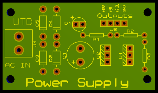

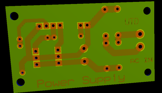

Now once the circuit is simulated and working fine, them its a time for PCB building.
Goto Tools == > Create net list then click on this option. You will get new window for PCB design and working suit.

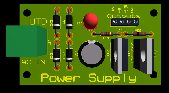

There you need to arrange the components how you need and create tracks using IPC standards.
Once completed, then Goto OUTPUT == > 3D visualization you find the design 3D model and dimensions.
Step 4: Final Look
This is final look of the PCBs. this files are send to manufactures for PCB designs and component soldering.
