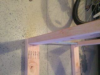

Step 1: Drilling
Drill the 2 foot pieces of wood into each 3 foot piece of wood at a 90 degree angle.
Step 2: Cutting
Cut the metal bar down to 19.5 inches
Step 3: Cutting
Cut each 33.94 inch piece of wood at a 45 degree angle at each side.
Step 4: Drilling
Drill each 2 foot piece of wood perpendicular at the other end of the 3 foot piece of wood.
Step 5: Drilling
Drill each 33.94 inch piece of wood into each 2 foot piece and 3 foot piece of wood as shown in the picture.
